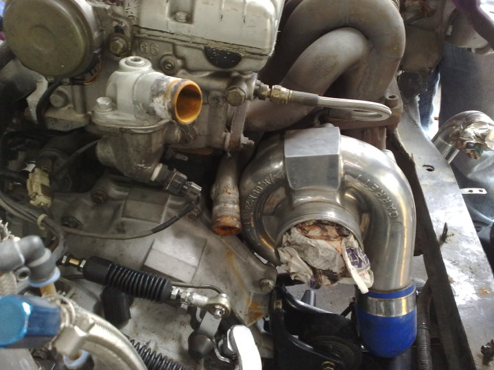

my exprerience has waisted on my own monster...:banghead:now starting back on P1000...
