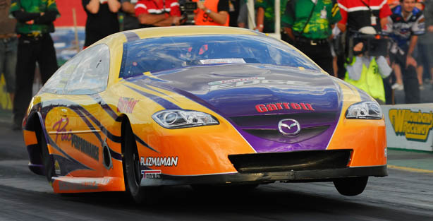

Haltech is proud to announce its partnership with Pac Performance’s racing team. After extensive private testing their Pro RWD Mazda 6’s engine management requirements is now handled by a Platinum Sport 2000 ECU paired with a Haltech Racepak IQ3 Logger Dash to cover its extensive data acquisition needs.
The PAC Performance Mazda 6 is a the current World Record Holder for both the fastest and quickest rotary car and the PAC Team are keen to hold on to that title and indeed try to get the car deeper into the sixes! The team is also looking forward to taking on their Puerto Rican rivals, renowned for their consistency and speed.
Note:PAC change Microtech ECU to Platinum 2000 on this jamboree 2010
