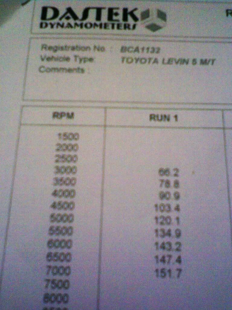

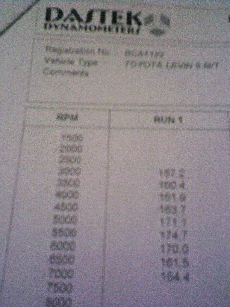

Info:
BT head, skimmed 0.5mm
Stock gasket
SVT block, SVT pistons, SVT conrods, SVT crankshaft untouched
Stock cables + BRISK spark plugs
C52 SVT non-LSD; dyno ran on 4th gear
BT flywheel machined to 5.5kg
Peak HP (flywheel - extrapolated): 151.7 @ 7000rpm
Dyno guy told me my car in particular had 20% transmission loss. i forgot to write down the actual WHP but i was told its 130~ish on wheel.
Peak Torque: 174.7Nm @ 5500rpm
very sorry for the blur pics, its the best i could get from my phone camera. :bawling:
an interesting argument between me & my mech ensued after the session. i thought that if i had dynoed with my previous full BT bottom end, id get more happy results. my mech however, pointed out that the lightened nature of BT conrods could lead to less peak & overall torque. issue is still unresolved till now. any thoughts?

Info:
Stock gasket

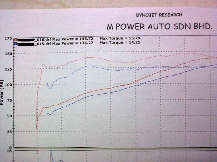

Hardly to get people believe it. On the dyno database, there is other 20v run there too. Stack it and it is real for sure. Lolx .. On the chart, note that there is 2 graph there. Before and after. That was only adjustment on the Fuel Regulator. The horse run up like a scramble boost on it's legs.
Well, when i say stock it is only the Engine. Hope i didn't mislead anyone. Here is what i can share.
Before the chart attached,
Stock SVT, with AFM still and stock SVT ECU, and the rest stock to the bone except Cap Kakimotor big exausht come by 135whp (with C56 gearbox)
After
Stock SVT, with Map and stock SVT wiring + BT's ECU, Fuel Regulator (still 135whp) but super choking effect for opening the throttles :banghead:
Turn turn the Regulator, magic happens. That is the before and after the attached picture. A big surprise. :driver:
Current,
Still break in condition, and will share up if it is a successful story.

After
Current,
