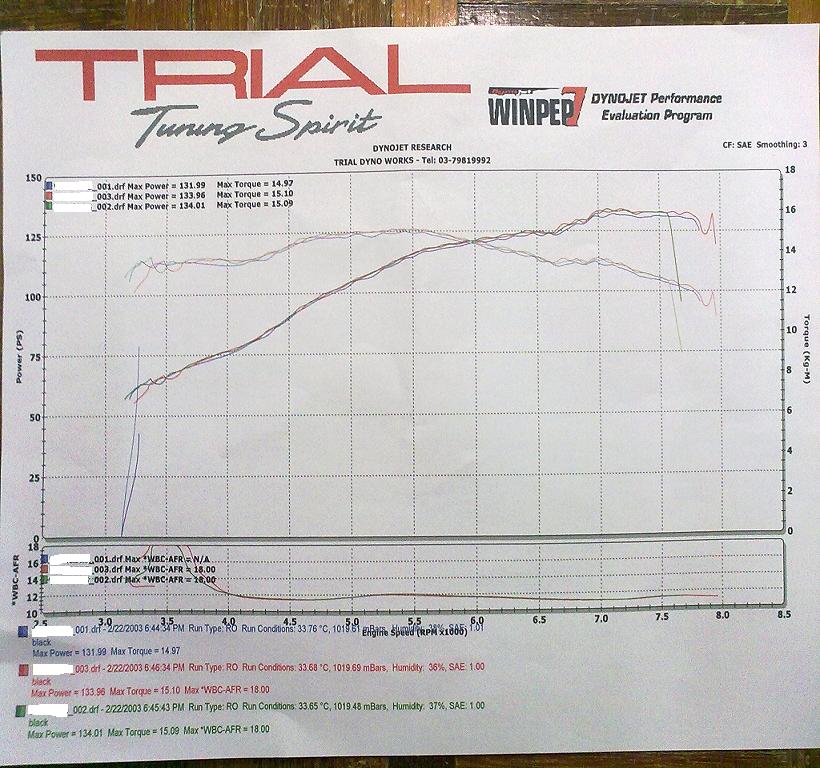

Just dynoed today...hope this is healthy one...
Engine:
BLT with 6sp
NGK Plug cables
K&N Open Pod Filter
TRD Metal Gasket
Apexi N1 piping with RSR Invidia S-Flow Muffler
The rest stock.
Is it normal that the max torque in RPM range 5-5.5k???
Cheers...

i though the stock BT hp is ~163hp? why from the dyno result it < 160hp ...
From wikipedia:
Fifth Generation "Black-Top"
The fifth-generation 4A-GE engine produced from 1995 to 1998 is the final version of the 4A-GE engine and has black cam covers. This engine is fondly known as the "black top", and yet again features an even higher compression ratio (11:1), the air flow sensor is replaced with a MAP sensor, the diameter of the four individual throttle bodies was increased from 42 mm to 45 mm, the exhaust port diameter was increased, the intake cam lift was increased from 7.9 mm to 8.2 mm and the intake ports were significantly improved in shape, contour and also the width at opening at the head was increased. This revision increased the power to 165 PS (121 kW; 163 hp) at 7800 rpm with 162 N·m (119 ft·lbf) at 5200 rpm of torque.
most forumer dyno their stock bt will get on wheel around 120-130...mean factory 165hp - 25% loss..around 120hp.... it mean factory 165hp is rate on flywheel...
u will get 160hp on wheel if heary mod....
