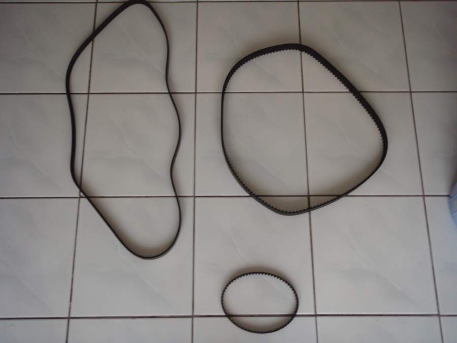

hi azizi.aziz,
i just sent my ride to the mechanic and they will figure out what's wrong/problems.
regarding the the belting... that's what quoted on my list given by them.
actually i don't know 4G63 required 3 beltings... and no idea which one is...???:stupid:
herewith i attach the picture of the belting has been changed (old item keep as
reference):
1- big (written: all the writing/mark gone)
2- medium (written: mitsubishi MD326059/153RU29/UNITTA/HNBRK)
3- small (written: mitsubishi MD18229/..... the rest cannot be seen)
hopefully you may guide/provide me any link or note to read about EVO 8 characteristic.
i already google around but can't find any....
regards,
pangyau...

correct.u need three belts.1 is the timing belt.2 is the balancer belt.3 is the belt for water pump,aircon comp,alternator and etc.
Hi Pangyau,
Yes, u need 3 belts.
1. Longest- the belt that connecting alternator, auto tensioner, Main pulley , power steering , air cond compressor...the code shud be 6PK 1800...just for your info the different between 5PK and 6PK it's the no of grooves (deep slot) on the belt...5PK got 5 grooves and 6PK got 6 grooves...the no 1800 is the length in mm...then u know how much different between 5PK 1170 and 6PK 1800...
2. Timing belt - standard size - no issue
3. Oil pump belt - standard size - no issue
Hi Pangyau,

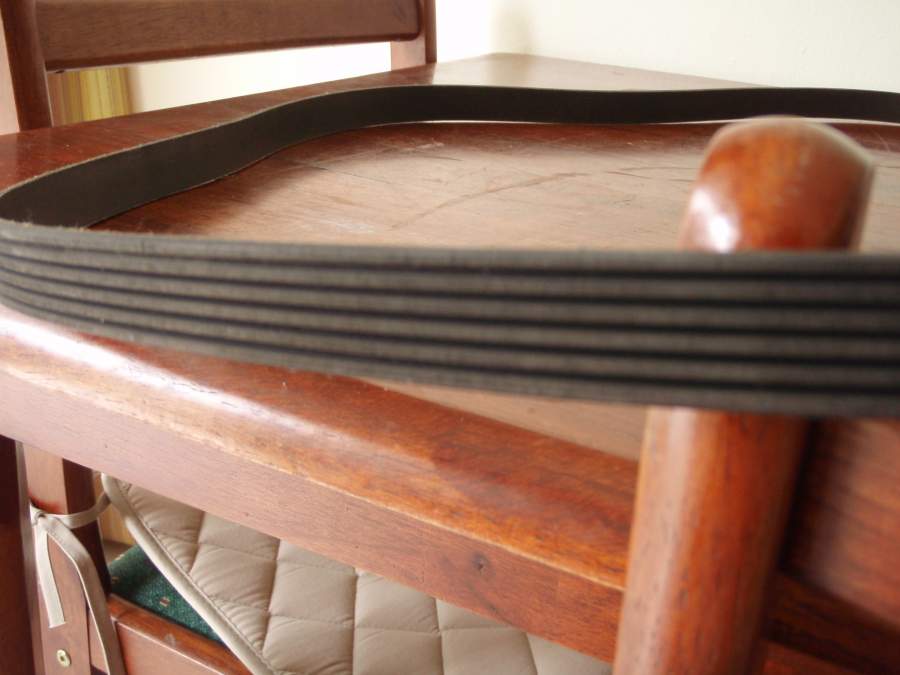

hi azizi.aziz,
from the given information by you.
answer 1: yes the original belt contains 5 grooves means deep slots :stupid: - (attach with picture below)
might be something different on this ride...
i on my way to the workshop look for my ride...
and i will look the belt has been install....
regards,

my bad...5PK or 6PK...the grooves on the pulley but on the belt shud be lines (upper bump)....from the picture...I can say it's 6PK belt...sorry...
hi azizi.aziz,
my bad also... coz of low knowledge of this...
i already seek the head mechanic regarding this... and confirm my ride use 6PK...
about my problem the "noise":
the head mechanic (the workshop owner) claim the sound came form the belting tensioner.
problem cause by his worker tighten the belt to hard and he already adjust it to the correct position.
now the "noise" problem solve i think/assume.... feel relief....
