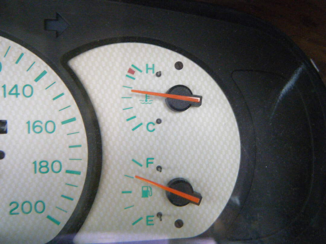

Anyway, regarding my car... I drove to Kampar and reached there safely now. But just now while driving, at a long straight, I tested the car by going quite fast around 120-130kmh. Was doing around 4000rpm. Not even a minute after doing that, my temperature rose up quickly. I need to release the throttle to let the rpm goes back down. Later on, I tried cruising 2 more times at 4000rpm and the temperature goes up very quickly again.
After I reached, I came down from the car and opened the hood with the engine still running. No leakage or anything. Everything looks normal.
This is how high my temperature went on until I release the throttle. Don't dare to press on the throttle further in case it spoils my engine.

Did you try off aircon? See the temperature can maintain. Just to confirm.
Tried. During the 3rd attempt cruising at 4000rpm 3rd gear with aircond off, temperature goes up just as quickly. It goes up really fast. Even faster than cold start to normal temperature.
Water pump was changed, right? Then next to check should be thermostat
Yes. Changed during January. Unless it broke down?
Even if clogged, temperature shouldn't rise up this fast I think. Last year when my radiator was clogged, temperature din't rise up this quickly.

as for your heating issue, i wonder if feeling up both the upper and lower hoses would tell you anything about the thermostat.... but if its not opening fully, probably cannot tell also...
Thermostat don't open easier to locate problem. If suka open, suka don't open or open halfway,sure difficult to find the problem.....lol:rofl:

Now very hard to tell what is the problem except that know I know how to make the problem appear. Make the engine run at around 4k rpm, temperature straight away shoot up.
