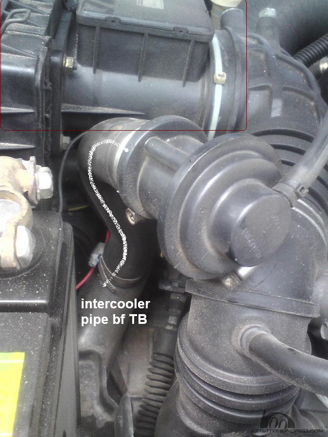

nah, u got it wrong
BOV and also bypassvalve sits in the same place , before TB, after Intercooler/Turbo compressor
even in the evo's , it sits in between TB and Intercooler/Turbo Compressor
ur picture below, u can place ur BOV anywhere between 2 and 4, u can even weld it on ur intercooler
nah, u got it wrong

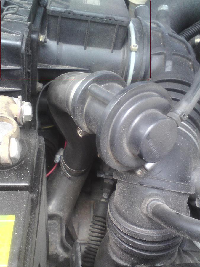

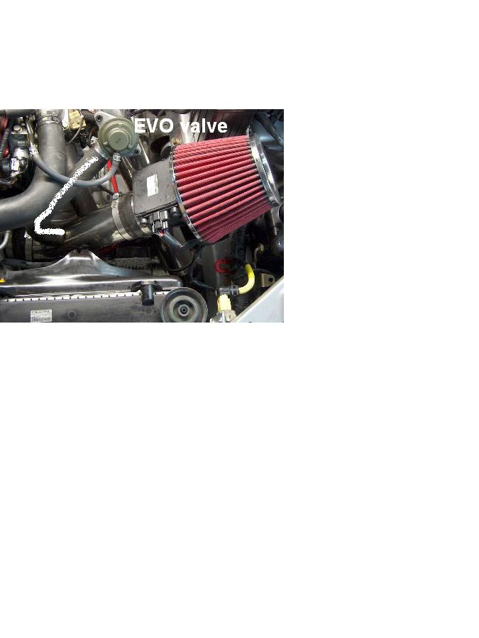

1. Evo 7 bypass valve sits between TB and I/C;
2. Evo 1 bypass valve sits between AFM and compressor (see attached pic).

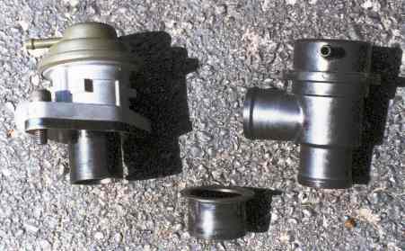

no laa brooo, adui
if u see ur picture properly, the bottom of the bypass valve connects to the intercooler piping
the top part where air comes out from the bypassvalve is rerouted back to turbo compressor inlet
nah hw a stock bypass looks like, the bottom part goes to intercooler piping, sideways one goes to AFM, thts wht we call "re-reroute"
this is a picture if the bypassvalve is replaced with a greddy
Bump: nah attached a evo , it also connects it outlet of the valve to AFM, same as older evo
garrett is correct :D
