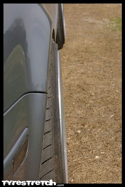

rather a milder stretch;
kerb scraping. yikes.
