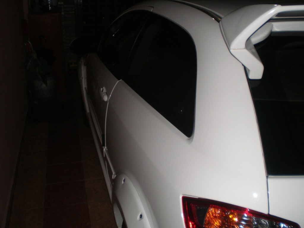

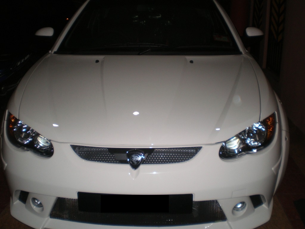

hi i just joined this forum.. i got my cps on 20th september.. so far there are no problems with the car.. only that rubber door stopper is only at the passenger side..so i go back to the branch and they give me 2 rubber door stopper..heheeh.. taken from saga blm rear side..
enjoy to forum with u guys..
cheers.
p/s ; mine is auto.. still havent reached 1000 km yet.. stil havent got the first service..
i got my cps throught proton edar branch setapak.. galleria sales gallery
