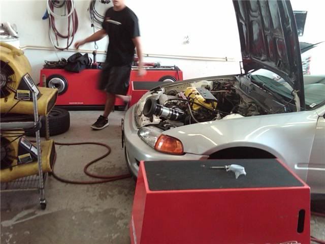

got to the shop around noon and put the car on the dyno to establish a good base with the rbc setup to compare to. the temperatre hovered around 90 degrees outside for our test and this was performed on a dynapac

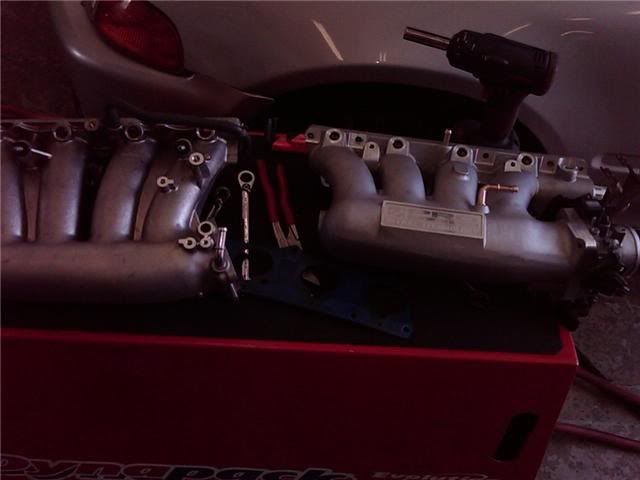

swapped intake manifolds right there on the dyno. and had it back put together around 3 (will be specific about the many fitment issues)

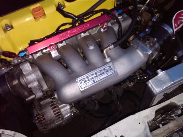

anyways another of s2's sales pitch's was how it will be convenient not needing an adapter, well what about all the fitment isses. the vacuum fitting on the s2 manifold are different size than the ones on the rbc so we had to change a bunch of hoses. (some fittings to large some too small) the manifold gasket had to be ground out to make the ports larger.you would think if they supply you with a gasket it would at least match the ports on the manifold. it was 2-3 millimeters smaller also the throttle body opening is much lower so my throttle body was pointing directly even with my upper radiator hose. we had to make a custom (read "janky") radiator hose with a dip in that location just so i could put my intake on the thing.
heres some pictures of the stuff we did today more will come and the graphs and everything as i get all of it sorted
