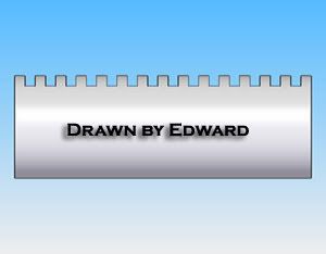

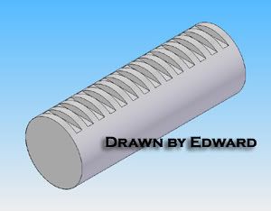

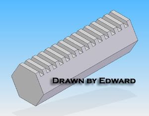

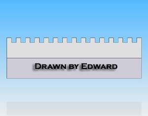

This post is regarding the cutting/lines pattern.
3D images below are drawn according to real life specification. The sample rod below are 30mm long and 10mm in diameter with 1mm depth of cutting/lines. And assuming that you are using knife/saw/dremel tool.
Let say if you use the hexagon rod, you result will look like this
If you are using the round rod, you result will look like this

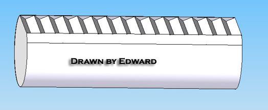

AND..... This is the cutting/lines of the actual BMW 5 series angel ring. I nearly got an actual sample of this ring back home from a wreck 5 series headlight. :-(
See??? The cutting/lines are actually different. It is not up and down but 45 degree cutting and surrounded.
Bear in mind that i haven't get the difference/result between these 2 different patterns in real life as i haven't got the time yet. haha
