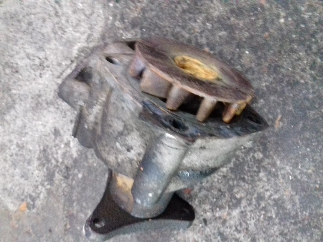

dear bro parakey
waterpump changin inprogres, car stil in wokshop, datday it brokdown, gasket burn due2severaltimes overheatin, so its undergoin heart surgery ritenow haha
yaok iwil pos d foto later
dear bro parakey
