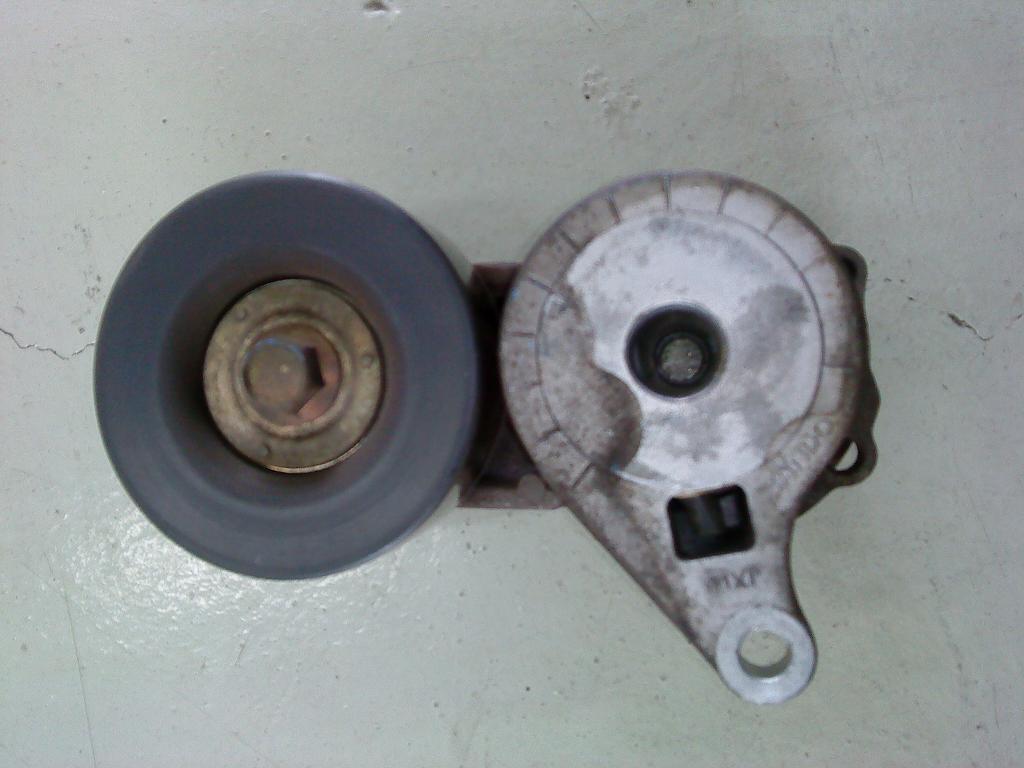

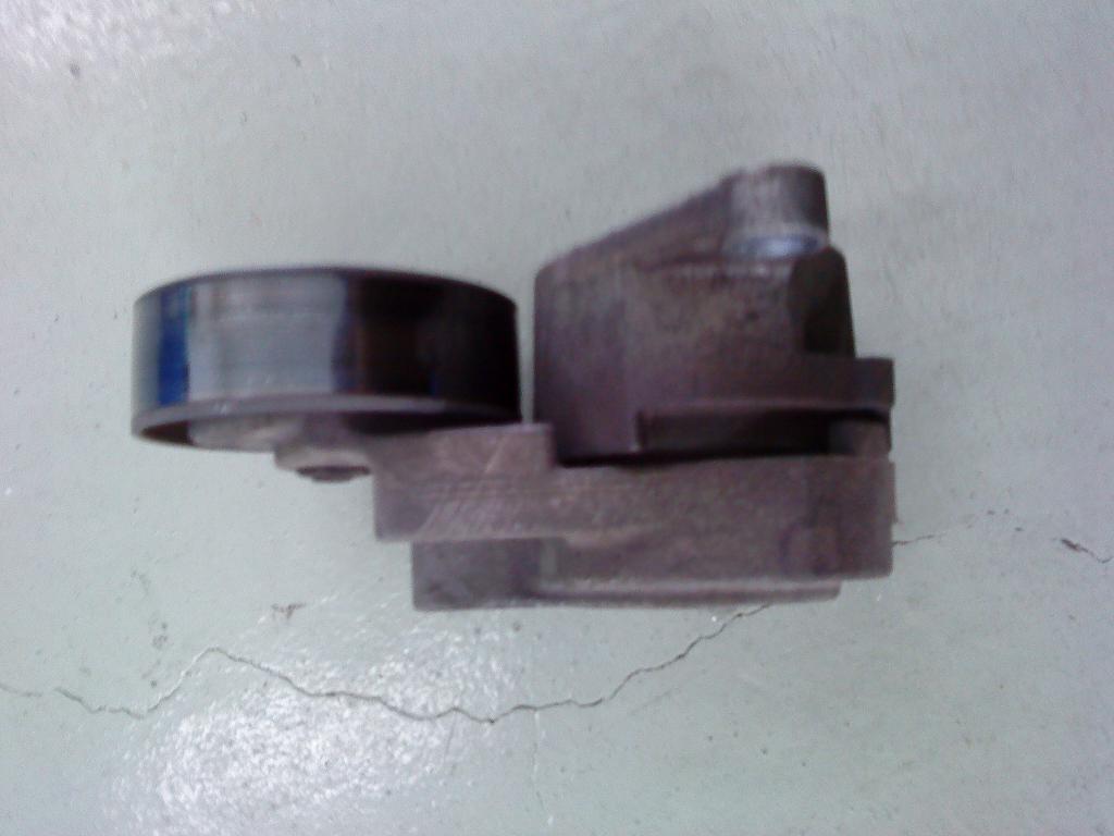

The rattling metal sounds due to this x bearing thing below (forgot its name), refer pic below. Changed mine last time, and the rattling metal sound gone. Its related to the front belting..price quite cheap (forgot the price and where bought it)
As for the speed vibration, go and check your drive shaft..
Where is it located?
Is it the bearing from the long shaft? I recorded the sound few times with success, and i showed my mechanic when we come out yam cha, and he said should be the long shaft bearing. but haven't check on it yet cause busy with work.
