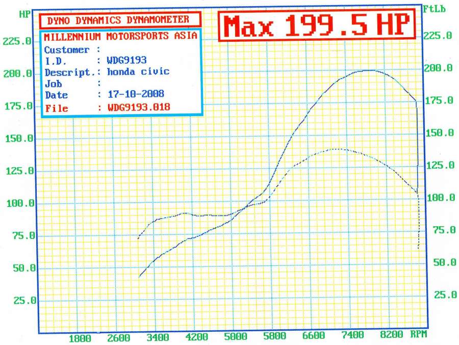

Update New Whp for EG B16.
WHP 199.5 Torque 140Ft

Bro the engine not same 'Perangai'....but the 4age still power coz of using the TRD gear box and ratio....next year come a new engine set up...and we work together.. hehehehe
wow..very impressive improvement..
but i'm just curious why its torque to low compare to previous 4AGE junk yard FR:confused:
B16 = 153.9/199.5hp Torque = 114/140 Ft
4AGE = 147.5 hp Torque = 134 Ft

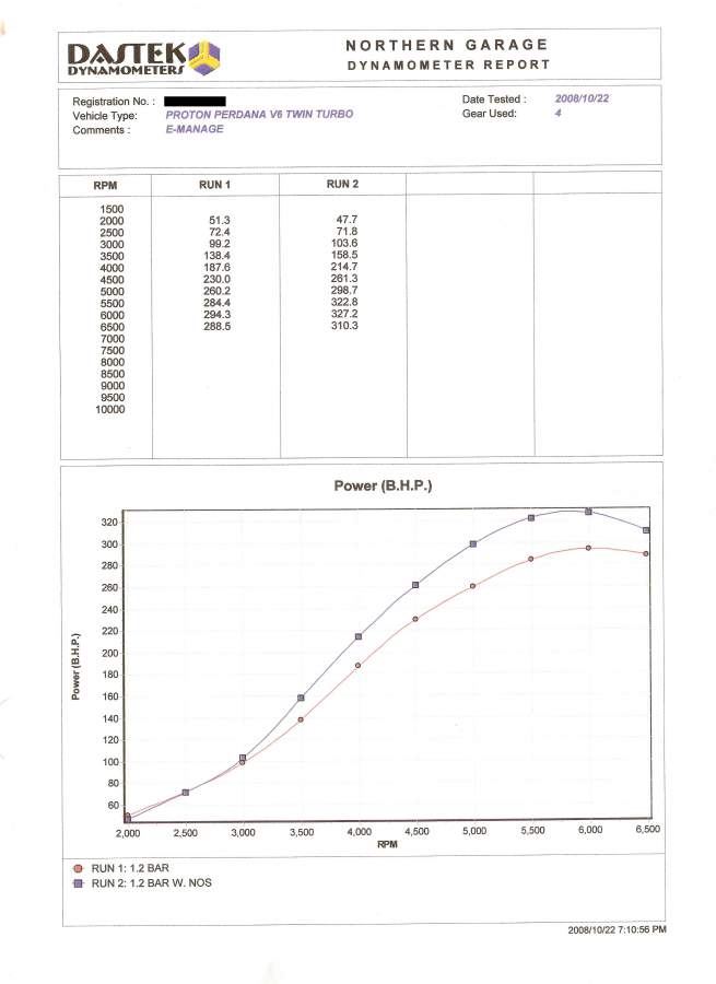

here the spec for V6TT
1. engine standard gaban + mivec gearbox
2. injector (original V6TT)
3. 6A12-NA ecu + e-manage (blue) + E01
4. wastegate cap ayam + HKS SSQV BOV
5. Hot Inazma (complete set)
6. Spark Plugs (OHS - or sumthing like that)
7. NGK cable plug
8. Intercooler (custom - size of evo)
9. NOS
10. Boost at 1.2 bar (the run profile as at attachment - with and without NOS)
the value for NOS run is higher (370) at first but due to nearly empty of the gas, the value gone down and the higher value (370) run had been overwrite...
NOS had refilled and going to perform another dyno (trying to achieve 400)...
