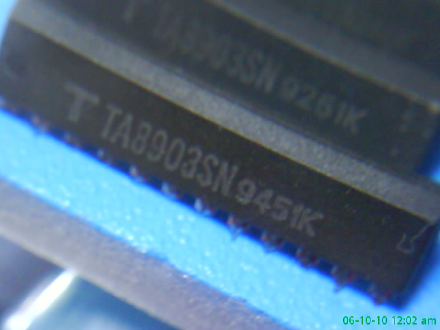

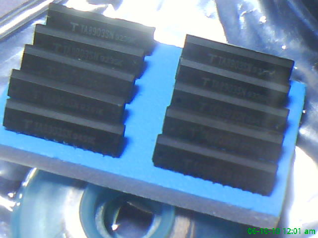

Ogip... try change this IC....
Looking at my stock, you should understand.... tq
Welcome... Keep me updated okay...
E-tech,
I had a hardtime desoldering the IC-TA8903.
I replaced it and now the ecu is functioning and running great.
Another ECU saved and thank you very much for the great help.
Welcome bro Ogip.
Send me some "balut".. :-)
next time just bend it left and right until it breaks off
then only desolder pin by pin. Easy.
