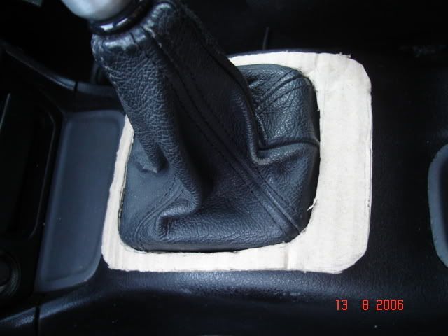

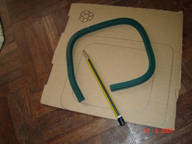

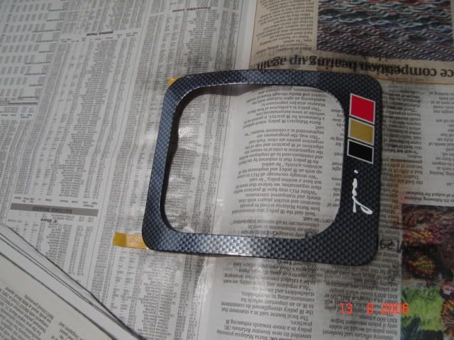

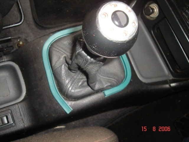

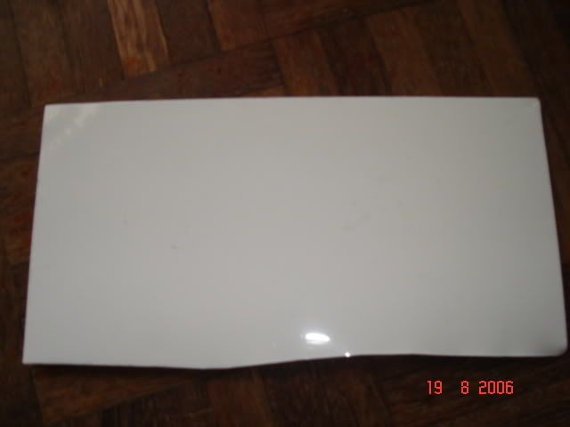

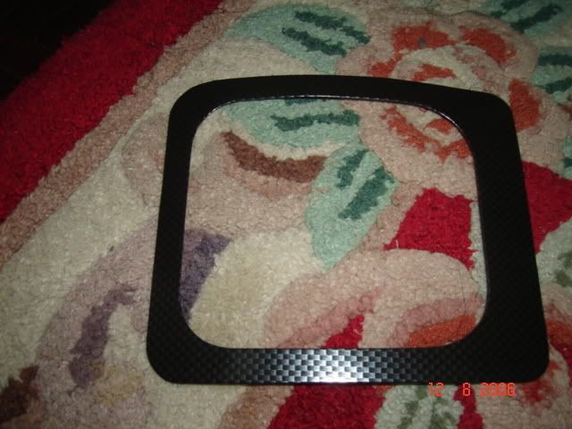

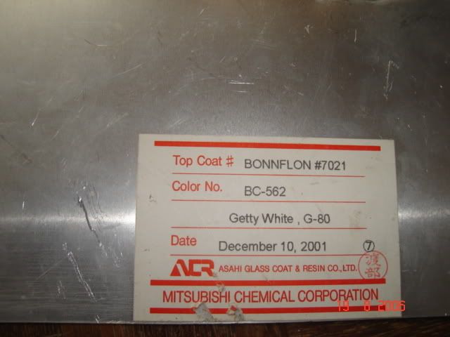

aluminium plate, abt 0.2mm thick... saw this sample lying in my office for years... so i tot of giving it a better life...
its code

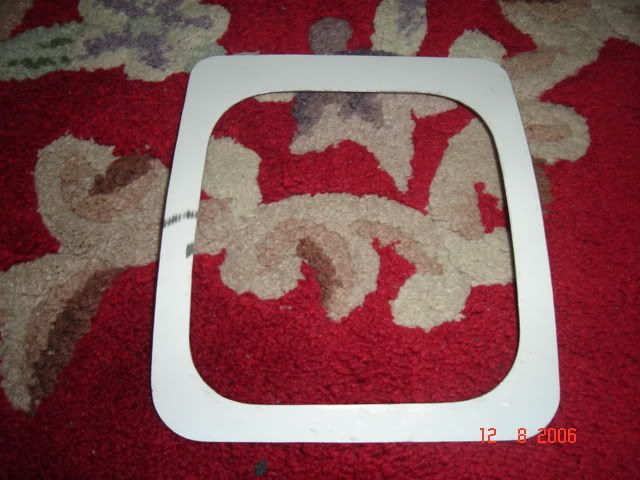

cut them to shape.. i just used normal scissors to cut, cos its not dat thick... for the center i drilled a hole n then continued cutting wit scissors.. then sand the edges using sand paper(metal)
