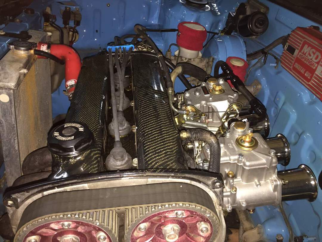

Long time not login in zth forum. Nice to know have other interested in carb especially weber. I also source my Reproduction Twin Weber 45 DCOE from turbogemini.com. Yes to fit in your modification carb don't go to workshop/service centre that cater many clients that come for service or standard repair, they simply don't have time to do modifications. As you said better find workshop under the tree. I'm lucky have friend workshop, I source for info from internet he do the work.
By the way I'm fitting the DCOE to my Iswara :)
Woh! twin side draft Weber 45. Won't the fuel feed be too high for a 1.5L engine?
Not necessarily, just need to properly tune the jettings (idle jet, pump jet, main jet & air corrector also the venturi size) to suite your engine. For now I can get around 300km per Rm50 ron95 (recent petrol price) without sacrificing the power.
It takes me very long time to get the tune I need, but it worth it :)

Oh ya, just for info. When you fit in twin weber, advisable to upgrade your standard ignition system to performance ignition system such as MSD or HKS ignition driver, especially for old car. If not it will be hard to get it properly tuned as you will always running rich.
