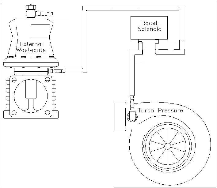

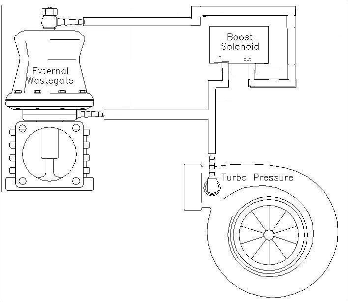

whats the difference between the 2 setup below?both also can control boost so wats the difference?
1st pic for low boost... 2nd pic for high boost applications.
freddy:wat u trying to tell?
alvin24:if i use the 2nd setup on low boost application wat will happen?wat boost lever consider low?and wat consider high?
use the 2nd setup.... it doesnt matter if you running high or low boost since the lowest boost you can go is determine by your wastegate spring rate...... normally ppl use the 1st setup if the external wastegate dont have the upper nipple or for internal wastegate setup...
Yeaps... like what cyborgsabah said... minimum boost is determined by the wastegate specs... what size/spring rate u bought lah? The box should have its specs written on it... unless u bought second hand, then u'll have to ask the previous owner.
2nd setup is used when the 1st setup can no longer hold the boost in a stable condition... ie: boost creep or boost leak. If boost spike, its usually the boost controller's fault rather than the wastegate/actuator.
alvin...so if the wastegate spec says 1 bar, does it mean the lowest boost is at 1 bar eventho we r using the boost controller to lower down the boost lower than that??...
sorry la for this noob question....i'm still learning about how this wastegate and boost controller solenoid work together....
cyphunk : yeap bro, if 1bar is the rate, no way to go lower other than changing spring

just use the second pic, the first pic is wrong it will just operate on the waste gate spring .. the second pic is set up correctly for using the boost controller...

use the 2nd setup guys...
the EWG itself will determine lowest/min boost...that is y when buying and aftermarket EWG u must know the spring rate as well.
use an electronic boost con to set how quick u want the turbo to spool and as well setting ur max boost.
