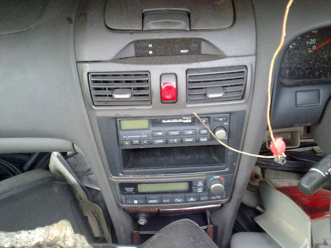

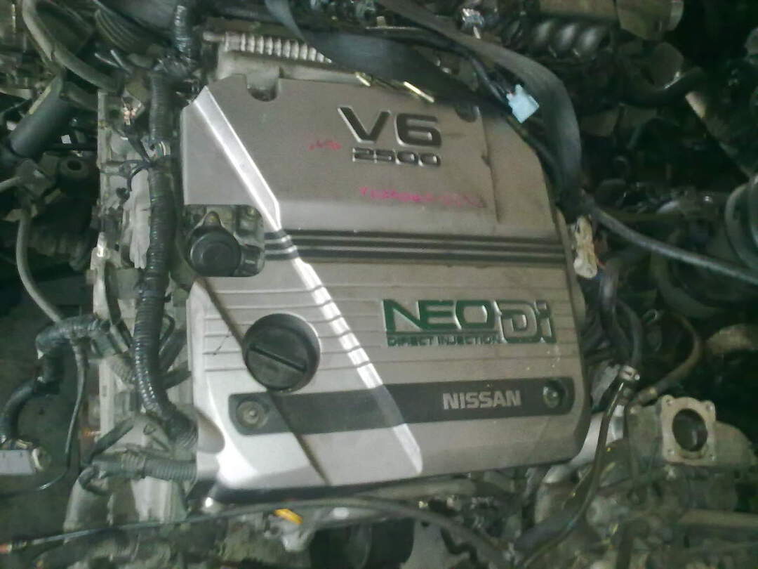

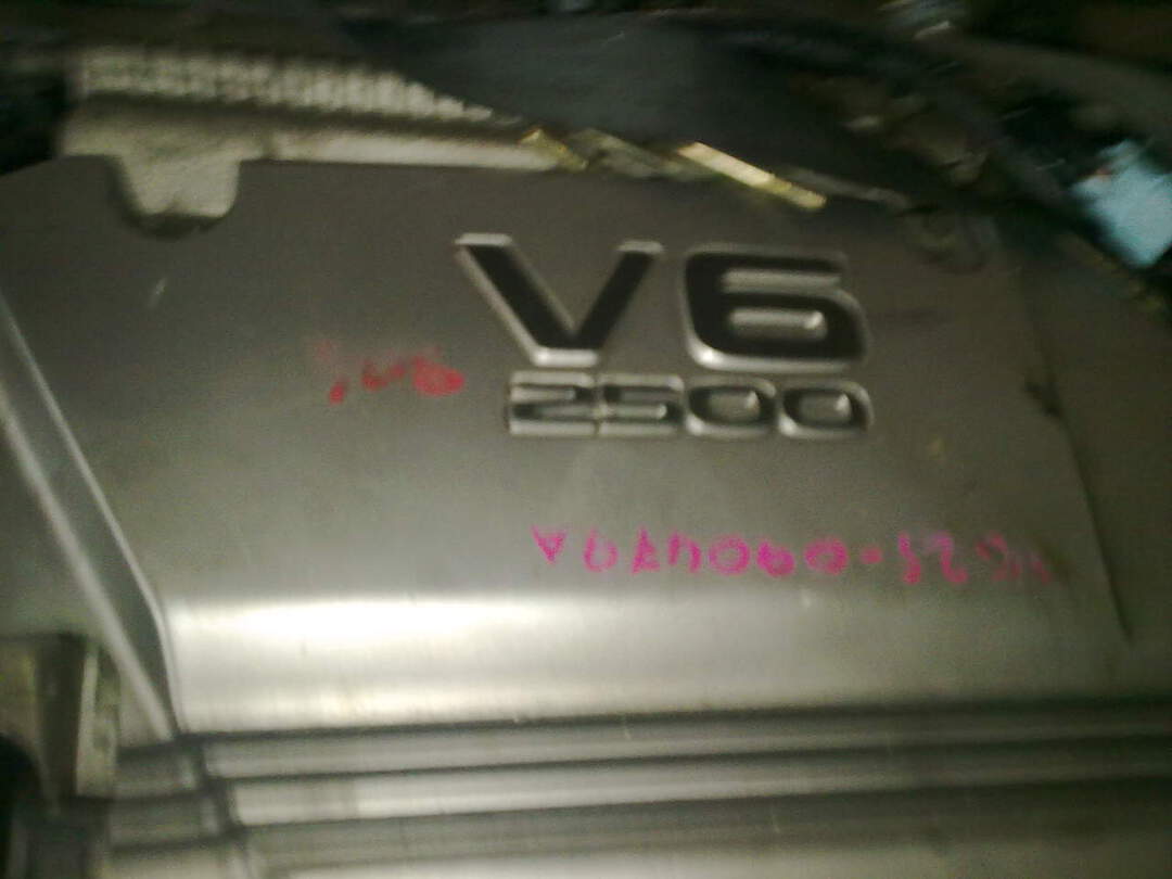

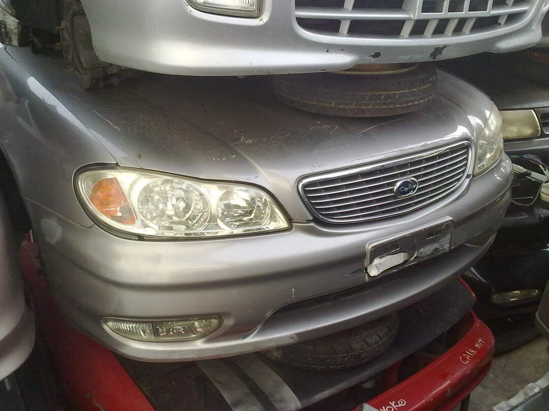

btw, I just found A33 2.0 manual half cut and a 2.5 NEO engine with auto gearbox and ECU, possible plug & play too. I didn't ask for the price, if interest can let me know.
RS5F50A Manual gear box can get around RM600 to 800 at Kepong area, go look c look c, got a lot of "Gold" mine there:biggrin: but I get my "spare" MT for next project from Jalan Kapar.
Here we go.
A33 manual and 2.5 Neo
