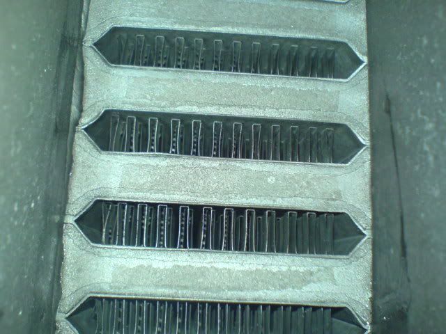

inside of the china/taiwan intercooler
crooked fins

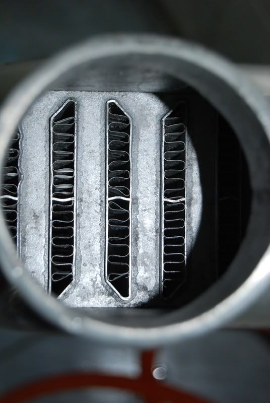

inside of arc
some of the arc model got different inlet and outlet,the inlet fin slanted.reduce lag

lan_evo: ohh, good information there. so basically the difference is on the inside.
