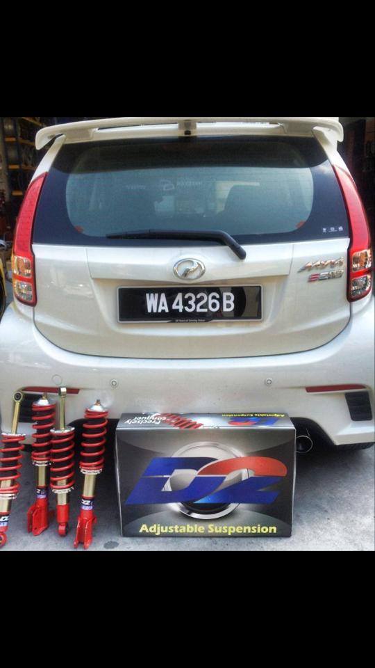

Someone offer me with taiwan made D2 hi/lo adjustable absorber .. and custom spring rate 6k at the back .. price around 1.3k with installation and aligment ... how was it ? View attachment 523007
provide me with some idea ... is it worth ? :vollkommenauf::vollkommenauf:

U a track kaki till u need 6k at the back?
Worry that your car will hop on bump.
Normal setup is 6k front, 4k rear.
Then again, do u really need adjustable?
If not the a good combination of absorber and spring will do just fine,cheaper too.
From the pic, its not bodyshift type so when u want to lower your car u will be compressing the spring more and thats not good.
I would strongly recommend to for same design for the rear setup. If your car has an absorber separated from the spring then if u want to change do follow the same setup. Why?
Because i have seen a pic where the absorber mounting snap as i cant take the aftermarket suspension load.From your pic the rear setup is coil over, i doubt your stock rear suspension is coilover.
Thx for info ... so means i should go for non-coilover type ? the reason i go for adjustable is my rear tyre was rubbing the fender when load with people at the back .. currently using lower spring with stock asb .. and now rear asb leaking already .

sorry man i think i make some mistakes .... actually 6k is at front n rear is 4k ... get it wrongly paiseh :vollkommenauf::vollkommenauf:
Should still be bumpy for you. My VR though heavier car is still bumpy and I am on D2 also.
Springs set the lowest, means hand tighten and damping set at step 6 all round...![]()
Thats the problem with lowering a car which u will used to carry people and putting aftermarket rim on it.
Yes, the best choice is adjustable.
U can get a set for less than 1k.rear absorber and spring is seperate.
Hi/lo only.
Lowerign spring does not work well with stock absorber, it it shorten the lifespan of the absorber.

So with sports springs it will not shorten the lifespan of the shocks right?
Is that all hi/lo adjustable can avoid fender hiting tyres when load with people ?
actually im not going to full load on my car .. but at least it can load 3-4 person ... sometime even i drive alone on bumpy road the rear tyres hit the fender 99 lo ... :vollkommenauf::vollkommenauf:
At least with hi/lo adjustable you can custom the height and damping. If scrapping then you need to adjust higher. Still hit, then adjust damping harder too, then the ride will be bad...![]()
