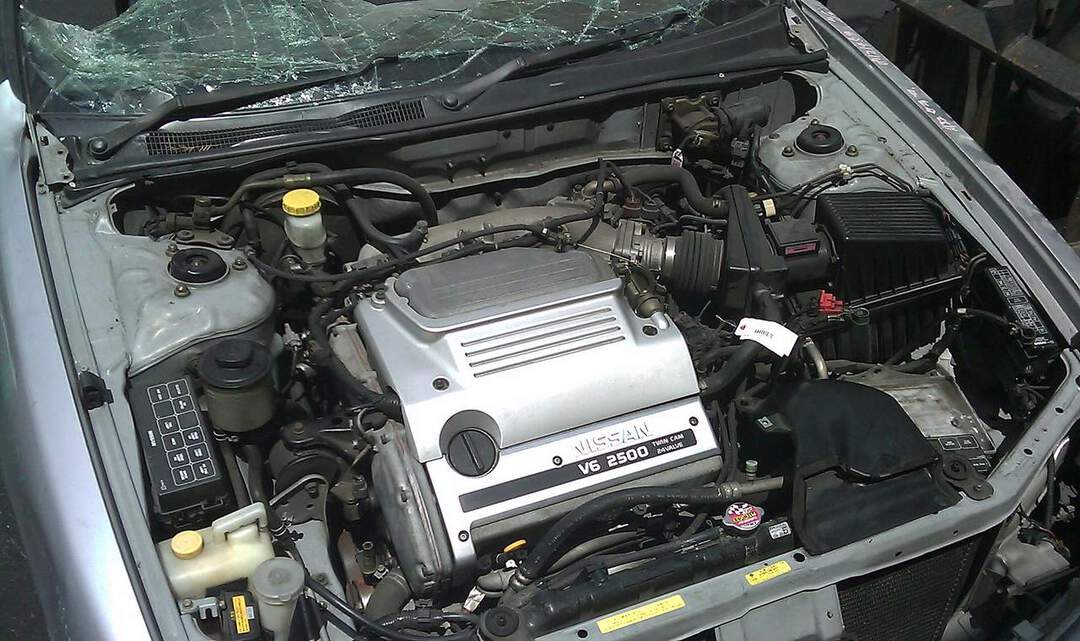

hi all,
after attending to some of the current issues of the car, including
1.some rather serious oil leakage from engine
2.this jerking problem
3.brake pump with minor problems
4.power steering pump leaking
i have come to a decision for a engine swap to VQ25 today, cos my company will pay for it.:burnout:
Got it from chop shop a half cut for rm3200 and installation for rm800. will do it this weekend.
taken a photo of the half cut as below
you still need to repair all the things you mention unless you get a new or very very good condition engine. that also will need about rm 800 to 1000 depend what you change. and spare another rm 500 for runner to change engine number, also update the insurance

even with the 1/2 cut you still need to change lots of things. unless you get a very very low mileage engine. i got my 3L 1/2 cut clock only 70kkm, and all the oil seal showing sign of leak, and i change all except the power steering hose. now the hose is leaking..
Is better to change everything when the engine is down, even water pump.
If the purpose of swapping engine is because trying to reduce the repair for oil leak, doubt this can achieve. unless you have a really good condition engine.
thanx for the elaboration. mind to further write more detail what r the oil seals that u replace? I can use it as a reference. i'll pay attention to these wear and tear items.
after considering the repair costs, i think replacing the engine will be a better solution, as this current engine already clocked 400k km and it's time for it to retire. Problems are everywhere, including oil leaks, hose hardened and leaks, drive shaft, power steering, radiator, AFM, etc. Since I travel a lot, it would be a nightmare if it just breakdown somewhere in the east-west highway.
btw, this half cut mileage is 110k km.
Thanx a lot for ur input

Congrats! U got a very,very cheap deal! Glad u made a good decision . Since company is paying why not consider a VQ Neo? Don't mind me I'm just kepoh only...:biggrin:

Actually alot of halcut items depends on luck lah. For instance the I've only changed the CV joints & Shock absorbers (Due to lowered springs, my fault.), Radiator top (due to using ron95, my fault also.), engine oil, atf, battery,etc. Its been more than four years now, still in good condition. I don't travel alot though.:biggrin:
To check for oil leaks is easy . Just start up the half cut let it idle for 15-20mins, give it a few high revs , stop the half cut (engine) let it cool down . Jack up the half cut , crawl underneath, you should able to some damp oil sipping through the fly wheel oil seal (sand wiched between the g/box and engine) , timing chain cover, cylinder head gasket , etc.
eh? A32 can use neo ka? what's the difference btw neo and normal one, and how to differentiate it from outlook?
checked thru the engine visually, no sign of oil leakage. it's quite a "clean" engine. hopefully it wont kacau so much after swap la.

110kkm, time to change oil seal, water pump, and plugs. is much easier and cheaper when the engine is down. cause some oil seal like the flywheel oil seal need to bring down the g.box, and also take part pf the engine oil pan out.

jpn kia oledi clean the bay, thats y looks clean. there was no much oil inside engine or may be long time no start... its very hard see oil stain
drive shalf seal.. engine mount rubber.. absorber top mount.. those water hose.. radiator hose.. those ruber thing must change otherwise u need spend more after few mths like me :bawling:
take our advice, when the engine is down, especially for a32 the car is been japan maybe on the chop shop for many months / years oil seal and hose will be harden, and after running the engine for few months oil will start to leak.
Since engine is down change all the hose, and oil seal.
Don't use neo engine unless you plan to put in the a33 dashboard or meter cause wiring will be headache if you plan to use back all a32 dashboard and meter with neo engine. Air bag, i disable already, abs usually not much problem and can use the 1/2 cut.

Yes u have to swap everything over (except for the body)
Swap the dash if its better condition than your current one and make sure its the same hue with your other interior items such as door panels, carpet seats , cushion or else it would look like rojak A32.
Steering ? same as the dash, condition, hue and whether the airbag still intact?(or dispensed)
