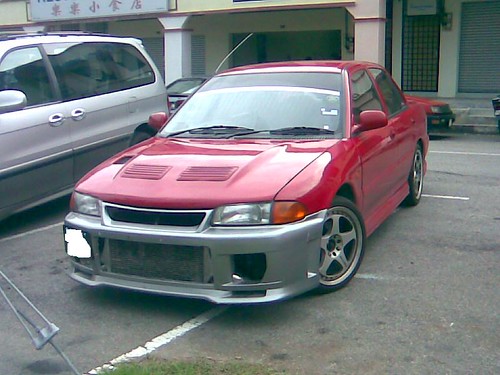

Btw Al,wana share the pic with us,can help promote..and price that ur asking.. can try help :)

Looks like this
It's a super rare item... not many people have it in Malaysia. It's ori stuff from Japan, came in with an evo3 halfcut. Took me quite a few years to find it... but decided to change car so it was never installed in my satria. I'm selling it together with evo front fenders for 1k.
I have an ad in ZTH, my contact number is there. If otherwise, can PM me also.

wooww,nice bumpers..whole set 1k?? oraitss..will spread d word around here.. but wud be nicer if there is an intercooler infront..hehehe
mine is still empty other then the air con condenser and radiator :P
