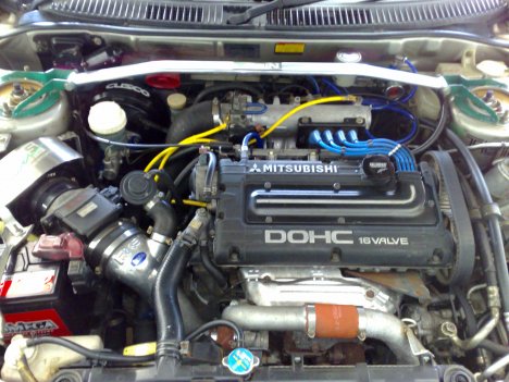

the different between 4g67(after rebore) and vr4 2liter is the oil squiter(cooling the piston) and the oil pump coz if u use 4g67 block need to buy oil adapter unless u can find the vr4 oil pump pnp only.so u used 1.8 block oso gain similar power lor but paying a bit cheap road tax..hehe thanks to all that replying my post and help
me build my 4g67 from 0-hero like jinkl,rpmracing,rsgang juz to name a few..:biggrin:
here some pic to give u more spirit to build u 4g67 bro...and
it juz to prove that im been trough all the process budy
not more then that....:driver:

bro trinityblood...how much the cost for u to rebore ur block??
now what type of pistons do u use??
i plan to rebore my block n use evo piston..is it ok??
cost to rebore block is not always same..diferent place may be dif charges..
but mine reboring and press the piston is almost rm400,im buying evo3 halfcut
so im using the piston back. After u done rebore the block and used evo piston
it should be no problem at all.we gain bck the 2 liter power budy....:listen:
