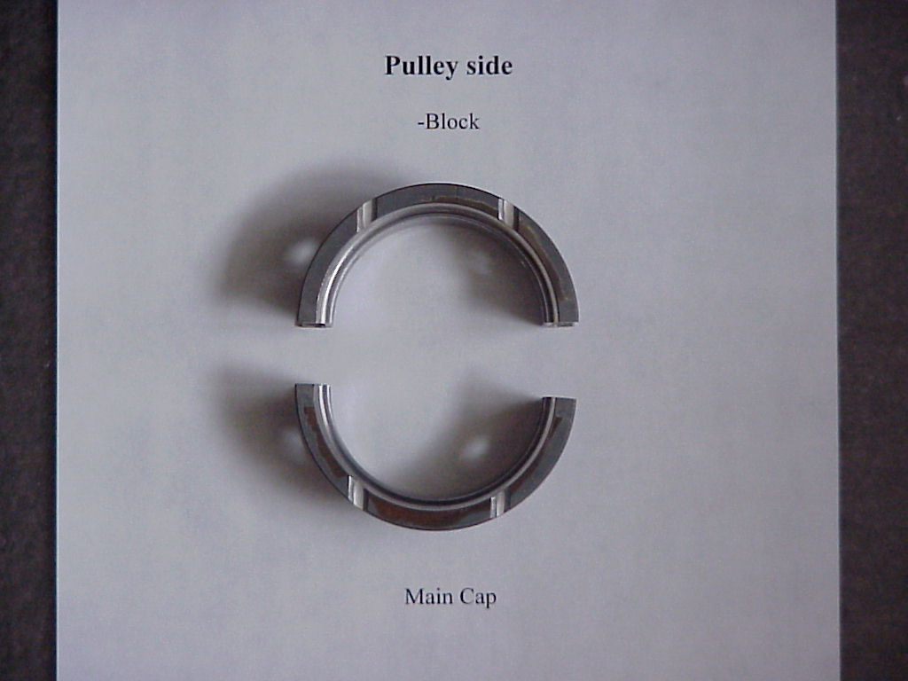

NEW Result is: after 8000 miles, the last 90 going around Pocono Raceway as fast as I could resulted in the thrust clearance increasing to 0.008! Out of spec! Ahhh, so what. I did another autocross after that anyway!"
* You can see the imprint of the block, and bearing caps oil passages.
http://www.angelfire.com/pa4/crankwalk/Mvc_046x.jpg
# Let the beating begin
# Here is the Pulley side of the bearings.
# You can see wear that is not uniform around the face of the bearing. This would indicate a slightly warped block, warped bearing cap assembly, or improperly machined mating surfaces from either.
