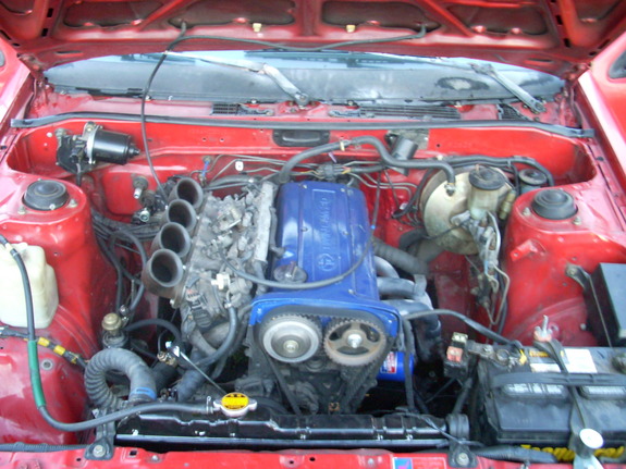

i think this setup is more powerful..
powerful fact can be clearly proof by dyno machine
or
driver feeling like pull force.. haahahahhahah
