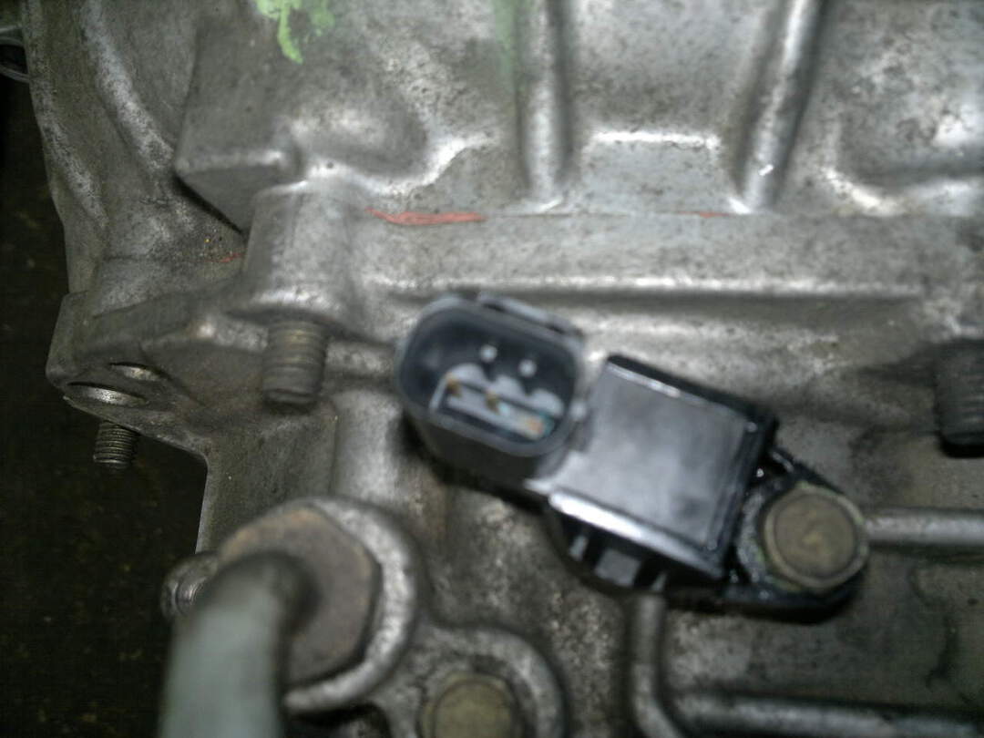

Hye all....nway my problem solved today....it happen because sensor with 3 pin socket broken...one of 3 pin broken...that why D always blinking...so anybody who got this problem dont worry...u doesn't need to change your gearbox....try check all your sensor,sensor socket and TCU...TCU only around RM 200-300...small sensor around RM 50-70....those price are halfcut item...if u want to buy new sensor...it only around RM 100-150...hope it'll help u guys....thanks all...
