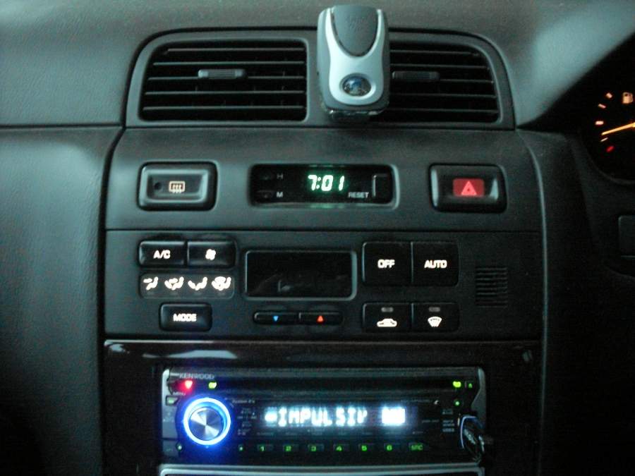

I will try to get some pics for you guys. Give me some time as I would have to take them out again. Will give you guys the resistor values as well. For all who doesn't know, this is a DIY job and requires some skilled soldering as the components are quite small like the resistor. The LEDs I used are bright white. Will take some pics of the lights in the car as well so you guys can see if you want to use white LEDs. I prefer white personally. The LEDs would have to be the ultra bright version or it will be too dim. So the regular red, green yellow all wont be bright enough. Also when installing the LEDs you need to make sure the polarity is correct when you install them or they wont work.
My Cefiro with DIY white ultra bright LEDs for A/C control panel.

Bro 12savefuel, can take some photo on the LED soldering side? Interested to know how you manage to squeeze the lead into the bulb holder.
Thanks:biggrin:

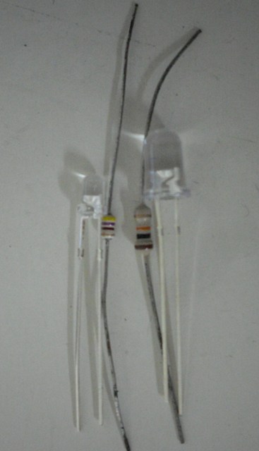

The LED is the 3mm(smaller) not the 5mm type. The resistor is used is 1/8watt with colour code: yellow, purple, brown, gold. You need to hunt a bit for the 1/8watt as not alot of people stock it. Once you get the parts you need to solder the resistor as close to the LED as possible. I hope this helps, I don't really want to open up my panel back up just to take the photo if possible as it is a real paint in the ass to do it. But If you really still need it just ask and I will do it.

Aiya... I actually want to see how you wind the lead into the bulb holder...
The lead of the LED is so much thicker than the bulb lead. Can go in meh? If too troublesome then never mind la...
Thanks anyway bro... :proud:
Yes it can be wound around the bulb holder like the original, its not too thick. When I free I go and take pics ok. Also make sure when you put the completed LED back into the unit that you check the polarity before you install and turn to lock the holder in the unit.
