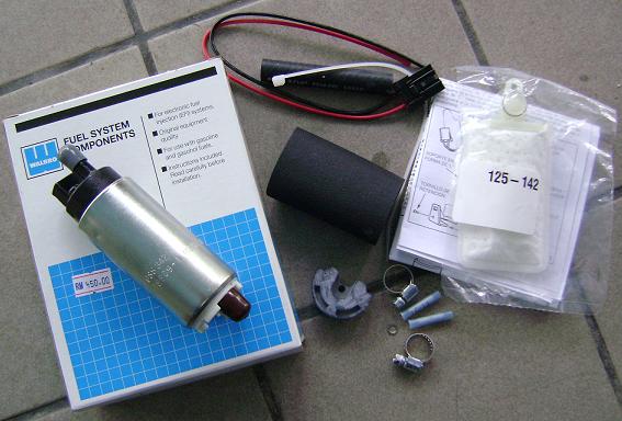

Prices has dropped drastically for these units as they are being sold as (pumps only) and you can source for your own filter unit and socket. FYI, they share the same power socket as most stock DENSO in-tank pumps. However, they are also available as in kits. Meaning, the filter unit, power sockets and install bits are packed into a single box for a specific application. But the price is of course higher.
http://a5.sphotos.ak.fbcdn.net/hphotos-ak-snc6/262171_213356502039416_111966582178409_575638_4311621_n.jpg
