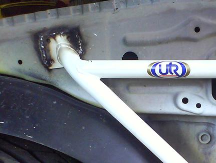

I have fender bars installed in my SO4. So far no squeak or weird sound. I welded it to the strut tower frame coz lazy to drill holes and get the bolts inside the frame :biggrin:. Futhermore, I think weld is stronger than bolt and it spreads the load onto much larger area.
I've already sprayed some anti-rust onto the welded area, inside & outside the frame to prevent rust. This pic was taken before that.
Probably no squeak cuz u welded it. Just wanna know if its necessary to weld. Afaik, after welding, *touch wood* u kena accident, itll be a problem then..
dun need weld la...look at those oem jdm fender bar....it all bolts on.......i dun see the point to weld it actually if u ask me :)
agreed...theres no real need to weld...
but personally id rather weld... coz the idea of drilling holes is a lil freaky for me.. if not sprayed over or watever...rust could build up

i agree with huakenny, BUT now that i found out need to drill? i think i shall weld.
