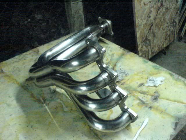

shiro, how u polish ur extractor? i spent 2 week poilishing it but still not shining... damn...
If really teruk, use 300-500 grit to remove those stubborn spots, then use a 1000 grit or higher to remove the scratches... you should use water to reduce the harshness, and you'll actually get a mirror finish. You can use the sandpaper along with autosol (without water) for faster results.. don't be too ganas, or you might rub too much metal off.
After that, wash with soap to remove those chemical stains, or else when the extractor heats up, it will stain on those places that have chemical residue (usually from the autosol) Wash it carefully, as even a bit of chemical/oil will result in those blue tints developing within a few days of use.
Be patient, as it takes quite a bit of work.. I do it one pipe at a time.. much easier to see the results that way.
The result....This is the second stage before final finishing with autosol.. I forgot where I put the original picture (before polishing)... but right now no time (although it sounds like a good way to earn extra money).. sorry hattech.. busy with worklah... unless you're patientlah... then I can spread out the work in two weeks...

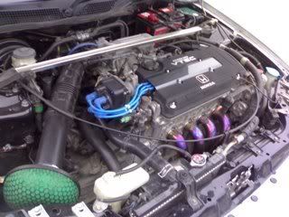

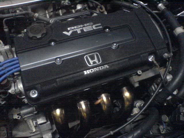

This is after it was broken in by use.... now bluish tint because got oil from various places.. I think some came from the dipstick hole.
