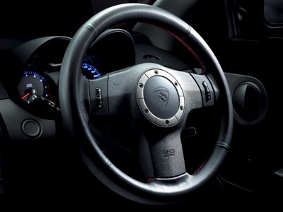

Hi all,
i am currently having an issue with my satria neo steering whereby theres a lot of free play and it is very unstable while driving as if the road is uneven, the car will sway by itself.. i went to 3 mechanics and all 3 said that its a "steering-rack bush" that needs to be replaced as it is bending everytime i turn. but i went to 4 - 5 sparepart shops and all dont have the part and they said that i have to change the whole steering rack as this fibre bush comes as part of the rack.to get a new rack, it cost RM1500.. :confused: .. recon rack cost almost RM700..if anyone knows where i can get the steering rack bush from or if you've had this similar issue, please advice how you solved it. thank you.
