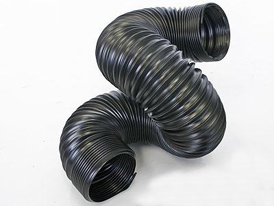

I'm preparing my few upcoming DIYs and some of them will be done over the long holiday break. But until then please enjoy something everyone seems to be fond of : Ram air intakes or Cold air intakes. It's not an exact science but Autospeed (whom I've been following for years) is pretty damn good at turning it into a R&D!
Michael Knowling who did the DIY essentially ripped out his old snorkel and measured where had the best positive pressure using a manometer and installed his ram air snorkel there. And he did it in his original VR4!
To achieve the greatest ram-air effect, you need to perform aerodynamic pressure measurement on the bodywork while driving on the road or racetrack. For this you’ll need a sensitive positive pressure gauge (or manometer) and a length of tube to probe aero pressures at various locations across the front of the car. (The frontal surface of the car is where you’ll find the greatest aerodynamic pressure.)
The ideal location for the air pick-up is where there’s the greatest build-up of aerodynamic pressure. This pressure can be harnessed to force-feed the airbox.
In the case of the Galant VR4, we tested aerodynamic pressure in the frontal cooling aperture (which feeds the radiator), the fog light area, and immediately below the bottom edge of the front bumper. At a road speed of 100 km/h, we measured 2.1 inches of water (0.5 kPa) positive pressure in the cooling aperture and fog light area. In contrast, the area immediately below the bottom edge of the bumper had negative pressure.
You sure as hell don’t want to mount your air intake there!
In this case, we decided to remove the driver’s side fog light and use the cut-out as our air pick-up. Why? Well, it’s in a high pressure area, it’s relatively easy to access and the pick-up can be made to look entirely factory.
Results :
With our new ram-air snorkel installed, we took to the bitumen with a couple of pressure gauges to check the results.
The first pressure tapping was in the new snorkel near the airbox. When cruising at 100 km/h, this showed a ram-air effect of 4 inches of water (1.0 kPa). This positive pressure build-up gave a noticeable improvement in throttle response.
And what about intake restriction at maximum power?
Well, the ram-air intake certainly gave an improvement – albeit not huge. Compared to standard, we saw a reduction from 27 inches of water (6.7 kPa) pressure drop to around 23 inches of water (5.7 kPa). Note that reduced restriction is from the combined effect of the ram-air pick-up and the oh-so slightly larger diameter snorkel.
Granted, these gains are relatively modest but they do highlight the effect that a ram-air induction system can create.
The most important lesson we’ve learnt is that a ram-air system can provide positive pressure inside the airbox at cruise. This gives a distinct advantage in terms of throttle response compared to a big diameter snorkel mounted in a low pressure area. But when it comes to making power, our old saying still applies – bigger really is better when it comes to snorkel diameter.
Still, if you’re up against space limitations or you’re reluctant to chop up the standard airbox you can find gains with this approach. We’ve proven it!
