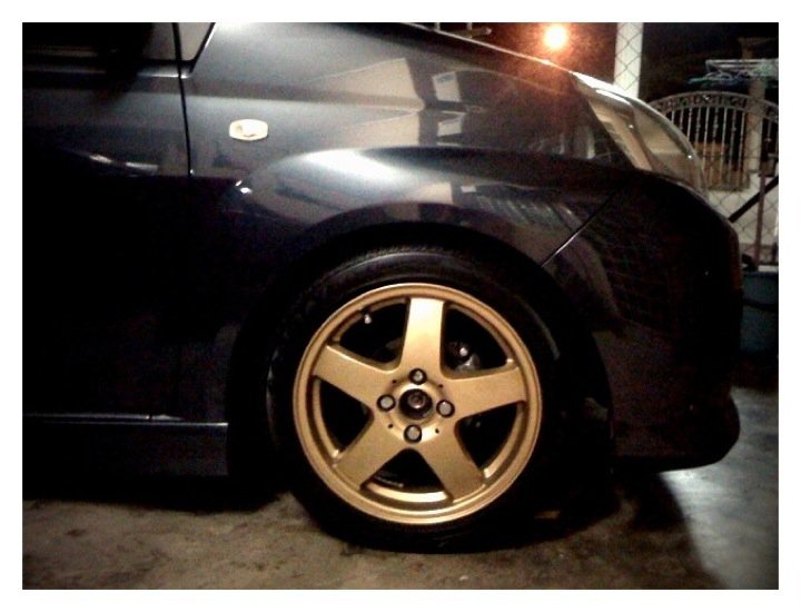

Hi guys.
Currently im using GAB sport springs for my car.
Gap between tyre and fender is as follow; Front = 2 fingers, Rear = 3 fingers
I wanna ask, is there any way to lower the REAR gap to match the FRONT? becoz now the car now is slightly 'tonggek'. not really noticable though..
I dont want to cut my springs or 'bakar' and compress the springs, as i heard this will shorten the spring lifespan and its not safe..
If i change my standard abs to short stroke abs, will it lower my car?
if possible i want to lower to 1 finger gap for front and rear..
Any suggestions guys? (except for changing to adjustable.. budget constrain la haha)

i did 'bakar' my spring previously and no issue with reliability at all... if 1finger i think no problem but if 2 finger lowered might cause damaged spring, thats what the mech said when he did my car, max lowered only 1finger if u want to 'bakar'

check ur rear suspension if there is a rubber spring seat... remove it.. it will lower ur car about 1 finger more... before installing back the spring, wrap the top coil with rubber insulator (garden hose for example) to prevent it from squeaking when it come in contact with ur metal surface....
it looks like adjustables is the way to go but i think its either you get a stiffer sports set (stiffer springs) or you stay with current one. you may also try to buy other lowered springs, but they may not match you current dampers very well.
its not safe to alter the springs in either way, those auto engineers have designed it that way and then you'd trust a car mechanic who may not even know what he's doing to your car by shortening the springs. plus you think it's easy to trim/bakar that thick wire to an even length? it takes heavy industrial machines to make them you know
when you shorten the stroke length, you need to have stiffer springs. later when you have to carry some load, you'll regret having the car lowered...you've decreased your stroke but didnt increase the spring rate, you'll start stroking the dampers all the way to the bottom

so u could opt to inject your absorbers to oil ones....but the ride will feel like adjustables.....quite nice......& u could choose the lowered height u prefer, front 1 finger, rear 1 finger.....

i think the ngek ngek sound could be due to the upper part of the spring (the coils at the top) being compress, thus rubbing against each other.. perhaps u can try Skywalker's suggestion by wrapping few coils at the top with rubber hose.. or perhaps u can try something called "spring buffer"..
another could be your abs KO already..
