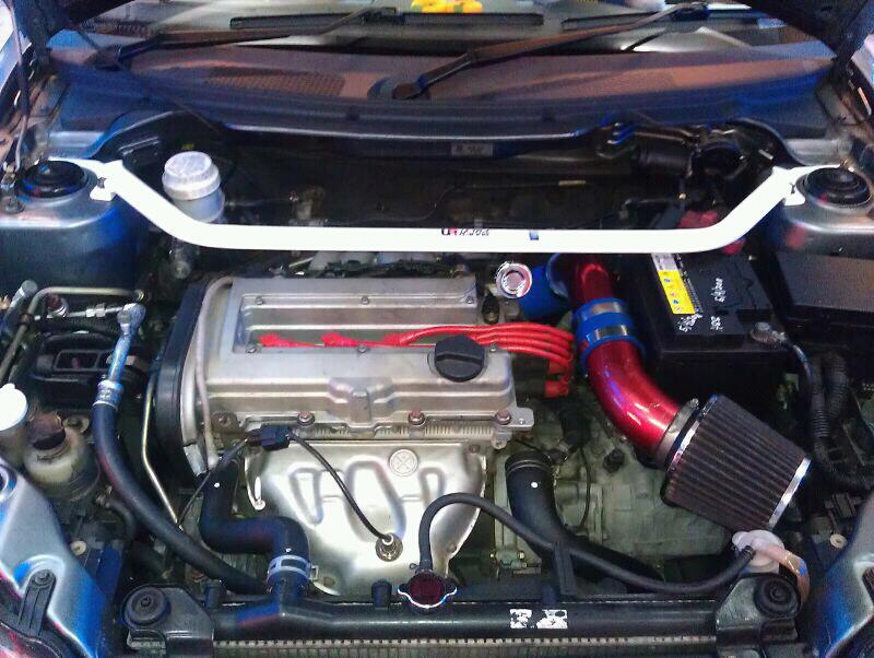

Mine is MT but what I did is to connect a pipe from the throttle body to the fog lamp. Then install an open pod filter.
I installed 3" pipe as thats the only size I have. Low end did not suffer but high RPM did improve a little. IMHO, do not use pipe any larger than 3" or it will affect your low end torque.
http://www.zerotohundred.com/newforums/members/xlimshady-albums-open-pod-picture7603-imag0191.jpg
Here's my setup..... Bought it 2nd hand from a guy who demod his satria.
Nice but it will be better if you can build a heat shield box for the open pod. Cause it is very near the radiator exhaust fan.

but mine is 2 pipes joined together, not a single pipe. The pipe is damn hot! anyway to insulate it? The workshop actually recommended me get carbon air intake (something like works' design) as they using plastic flexi pipe so as to not conduct heat (claim that it is same or even better than open pod) But I wanted to try open pod.. haha.

xlimshady.. how much did you buy yours? looks good.. only missing i guess would be a box for the filter so hot air wont come near it.. what escksu says is true..
holysniper.. u could try wrapping the piping like what xlimshady did.. use thermal wrap.. worth a shot..
Yup, I know..... maybe after this when I buy a new filter i'll find those that have those heat protective casing. But for now so far so good, bought the whole thing for 250 only. FC is very good. about 6.0 on highway if I cruise around 90-100km/h
