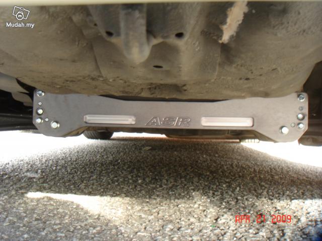

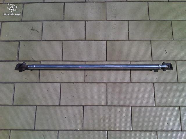

Hi all sifus,
Got to know that SPOON has comes out with lower bar & heard it's easily broken.
And now I heard there is a product from US that is ASR.
As I am using EG 2 doors. Rear anti-roll bar is using DC2 & CUSCO adjustable with camber kit.
1. So which one is better for my car setup?
2. Is this 2 stuffs is the same function? (please refer photos attached)
3. Which one is better?

sorry m speaking in malay for the best explaination...
ASR untuk kuatkan tulang subframe contohnye kalau awk pakai ARB yang besar mcm DC2 punye, bile ambik corner dgn laju,tekanan pada bracket ARB tu akan tinggi,masa ni la tulang subframe tu dikhuatiri akan cepat koyak n bengkok...sama la mcm body EK/EJ masuk ARB EK9...so ASR ni tolong support tulang subframe tu....tahan n sedap nak lap...
2. strut bar ni just utk sedap lap as die pegang hujung n hujung lower arm...since awk da pakai ASR tu tadi,mende ni tak pakai pon da sedap as awk pakai ARB...
*kalau ada salah silap harap dibetulkan...TQ.

I see. So if I choose to use the SPOON lower bar with my setup, is it more than enough? Or it's advisable to use ASR for my setup?
Just go for ASR you never regret on this product if you always track your car...
Even you install bigger antiroll bar ASR will help you not break your chassis
and you can think its thats spoon so small bar will help if compare with a brace by ASR?
