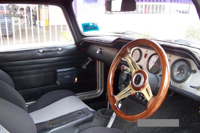

Hey guys, I got the Honda S600 off mudah.my
http://www.mudah.my/Honda+S600+1966-6103132.htm
The original S600 is crazy. Red lines at 9500 rpm!
The car was purchased new by the seller's uncle and was transferred to uncle's wife after he passed on.
Seller told me that the hood ornaments have been there for as long as he could remember (uncle used to drive him and bros around).
The shell and interior are still in quite a good condition, unfortunately, the engine and lights are no longer original. The current engine is a 31hp :slug: 659cc kancil engine with a faulty 4 speed gearbox (third gear dead). Anybody know where I can get an S600 engine? The seller was kind enough to give me the original gearbox.
The first thing to do now is to move the car over from Ipoh to KL. I don't think the car will be able to make it with its current engine and gearbox though. I can imagine driving it at 40km/h down the North South highway only to have it break down 1/4 of the way through :(

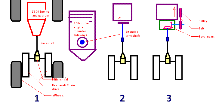

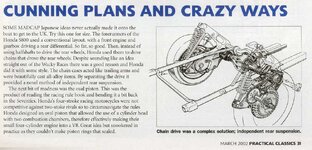

Using a bike engine in the S600
Pros
1. lightweight
2. comes with sequential gearbox
3. high revving
4. very cool
5. rare in malaysia
Cons
1. requires additional gears and pulleys
2. classic car no longer classic
3. additional device to automatically cut power off to engine when shifting gears
4. need to shift down one gear at a time, down till neutral when stopping.
5. rare in malaysia
Anyways, attached is a diagram of how I would connect a bike engine to the car and an article + pic of the S600's rear wheel drive.
Layout 1 = Original engine
Layout 2 = Bike engine mounted sideways
Layout 3 = Bike engine with bevel gears
prefer layout 3 because it is more flexible
Pros
1. lightweight
3. high revving
4. very cool
5. rare in malaysia
Cons
5. rare in malaysia
Cool project,
Can you not mod the clutch pedal to pull the bike's clutch?
