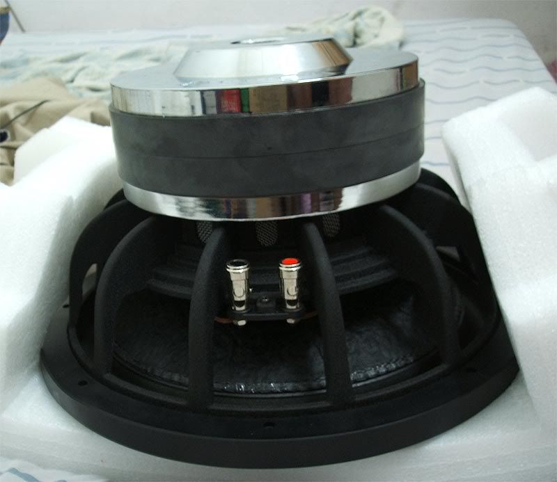

my friend just bought it yesterday and when i look at the specs its quite confusing.
it has no power rating on its manual and on the box stated 600w max so i assume it would be around 300w rms. But if you look at the subs it has relatively large spider and double stacks magnet and quite bulky and heavy but for 300w rms?
Another thing is it has huge foam sorround and when i look at the T/S parameter its only capable of 13mm.
i search online and couldt find any info on these subs. Now my question is.....
1. What would be the actual power rating and what would be the ideal DD (daily driver ) would powered it.
2. since it uses a large foam sorrround, i assume its a long throw sub but with 13mm xmax? Is it a one way linear xmax or peak to peak? Or is it capable of more???
3. what would be the ideal box volume for sealed and ported (box volume and port size and lenght) for SQ purpose.
4. Anyone who uses this sub can please give me a review of this particular sub.

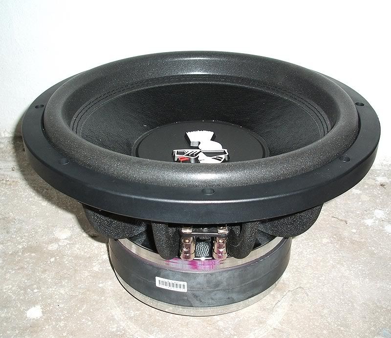

Mohawk ME124 Extreme Series Subwoofer
Hi all. Hope this will help you guys. The model for the item: ME124, Extreme Series Subwoofer. Please download the moh.doc and mohspec.doc to view the subwoofer picture and complete spec. :shades_smile:
Some preview on the Mohawk sub and spec. Detail info, download the attachment.
