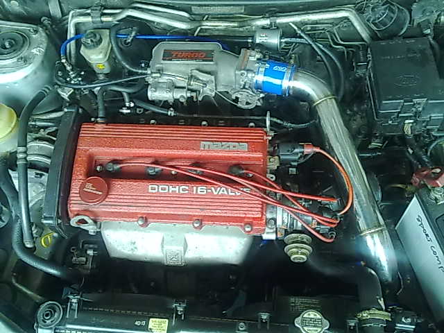

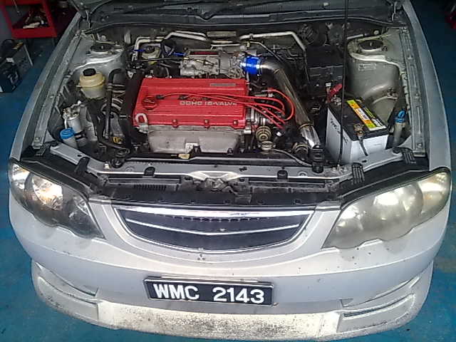

KIA Motor Swap to Mazda 1.8 turbo engine
Spec
1.KIA Spectra Body
2.Engine stock BP 1.8 Turbo
3.EMS Fuel Controller
4.Stock Turbo
5.Stock KIA Auto Trans
6.Walbro Pump intank
7.Fuel regulator
All Engine Mounting Remain OEM
look at the engine sound

wow....
the mounting from "mounting" itself to the engine have any change???? or u create a custom "extender" bracket to joint the mounting with the engine???
and what about gearbox to engine screw-point???use adaptor or fit 100%???
really need :adore::adore::adore:

Engine running nicely.On a low boost 0.6bar 154whp...but the problem from Auto trans it's not change the gear.Still checking and try how to solve the problem.
3rd gear car running 220KM on the dyno.
