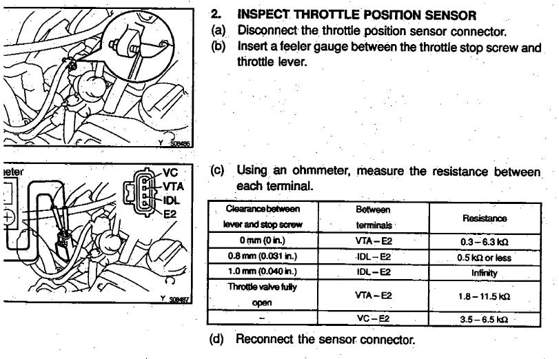

May i know how to check TPS position. I open the engine oil cover, i c sludge inside the engine. Do this affect the performance also?

See the attach pic. You can get it from BT sevice manual pg. FI-45.
P/S: you need to apply a vacuum to disable the throttle opener before you can insert the filler gauge between the throttle stop screw and throttle lever.
