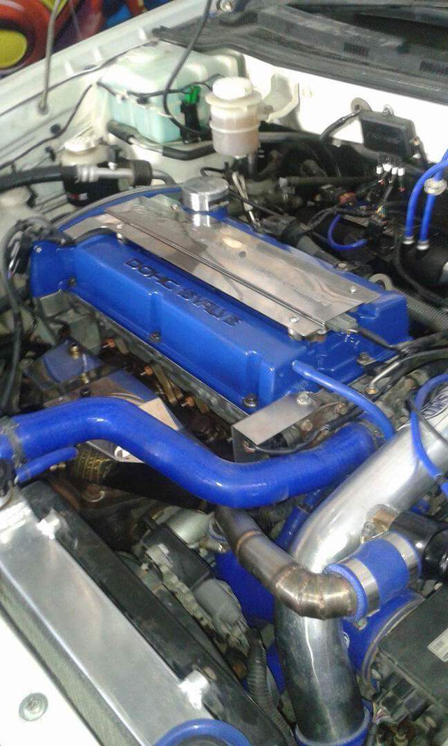

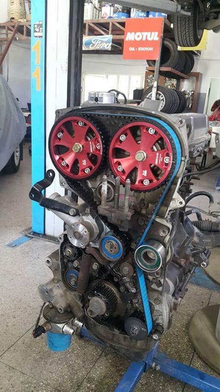

Well time to get serious full engine rebuild to make super strong for next phase the aim at the moment is to get to 500bhp and yes before anyone says the the gearbox won't take it you are right i am going to manual 5 speed so lots of pics to come :driver:
if anyone has done the manual conversion any information on how would be much appreciated

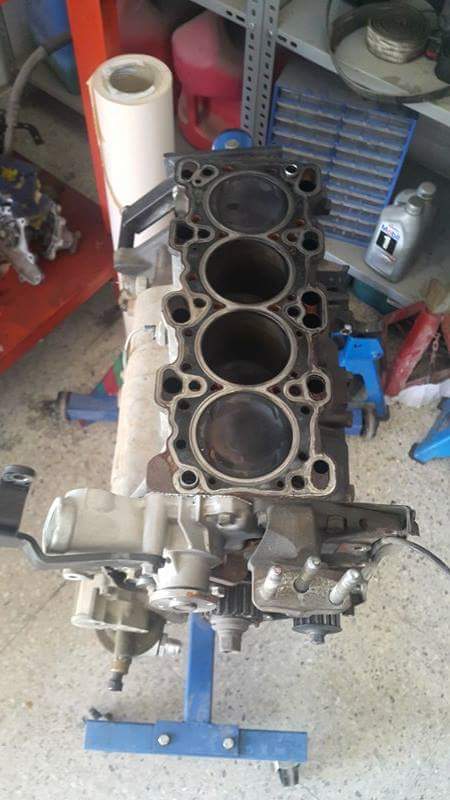

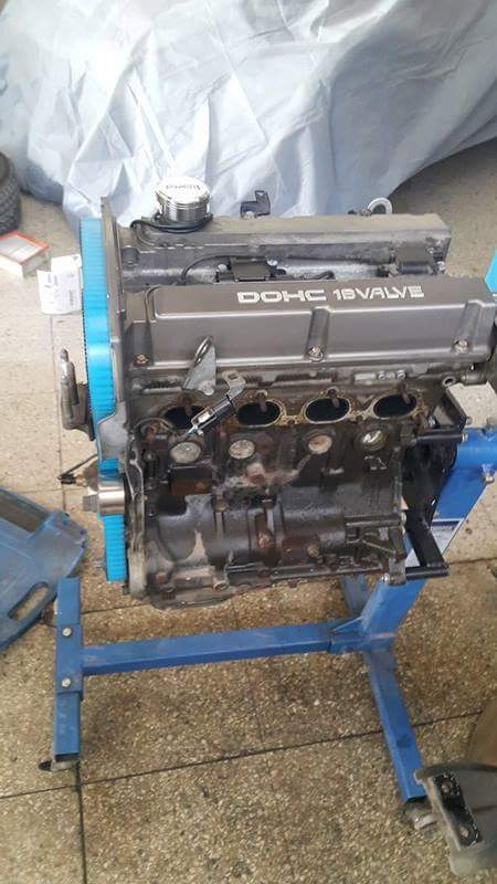

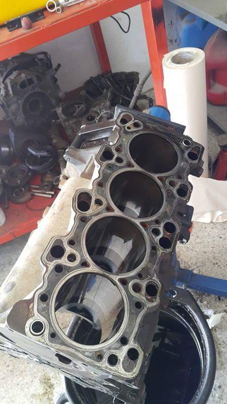

So todays mission was to tear down engine so we could get the block and head to the machine shop .and it all went well the internals were all in very good condition but we dont need them any more as all new is going back in.but was nice to see that the engine was in good shape so if you regularly do the service it pays off in the end :nurse:

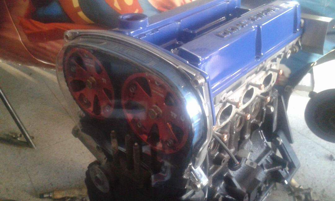

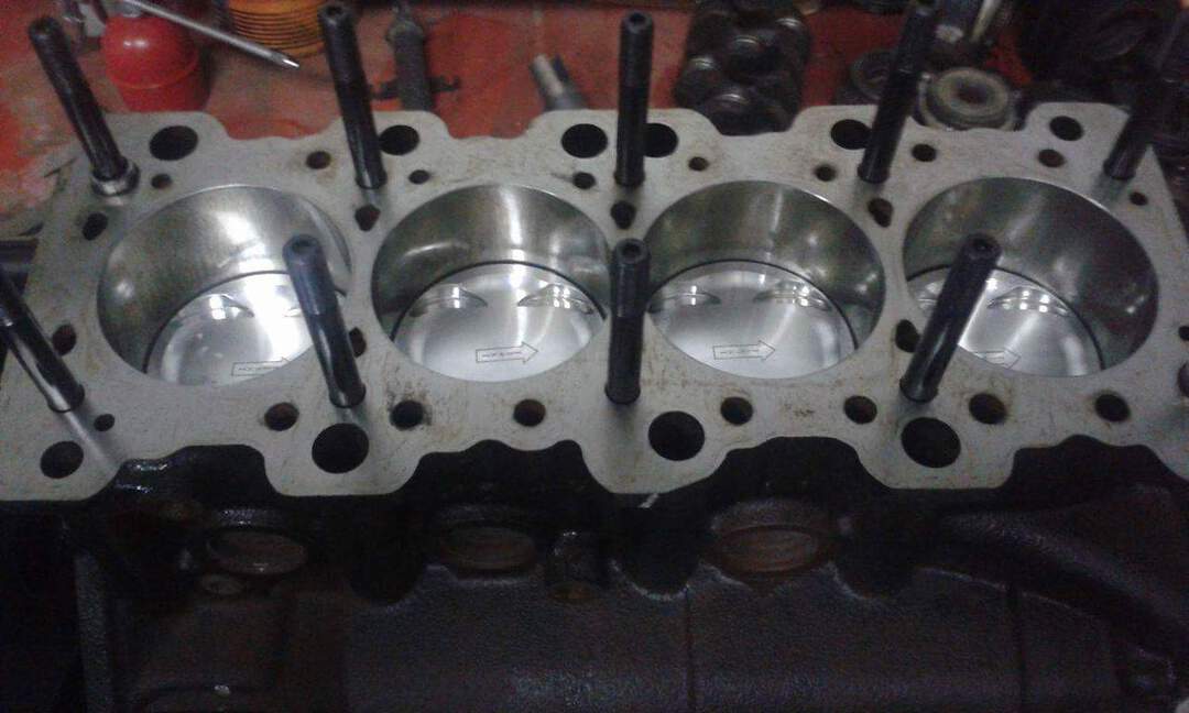

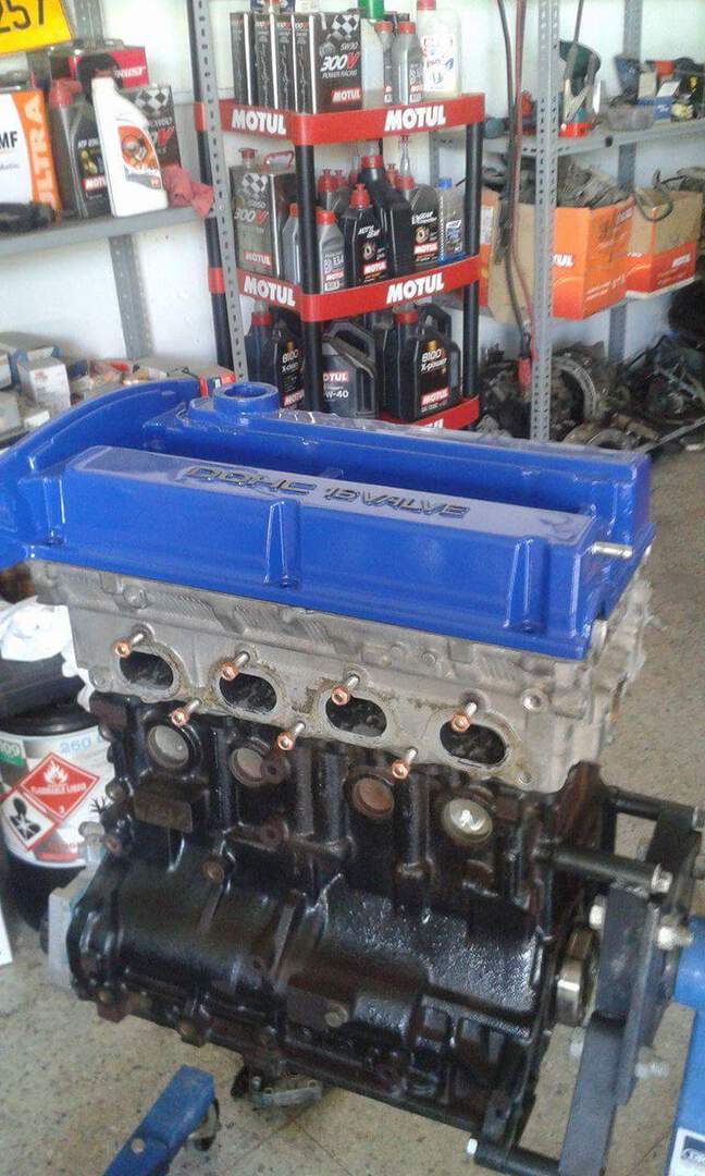

Well got the block and head back from machine shop then cleaned and cleaned again then all new acl bearings manley pistons and rods arp bolts then the slow and steady task of rebuilding check and double check everything going for super tight tolerance s .so all new valves tomei new springs tomei and titanium retainers tomei and cams and pulles which i all ready had so we are close to finishing the engine new oil pump as well and water pump

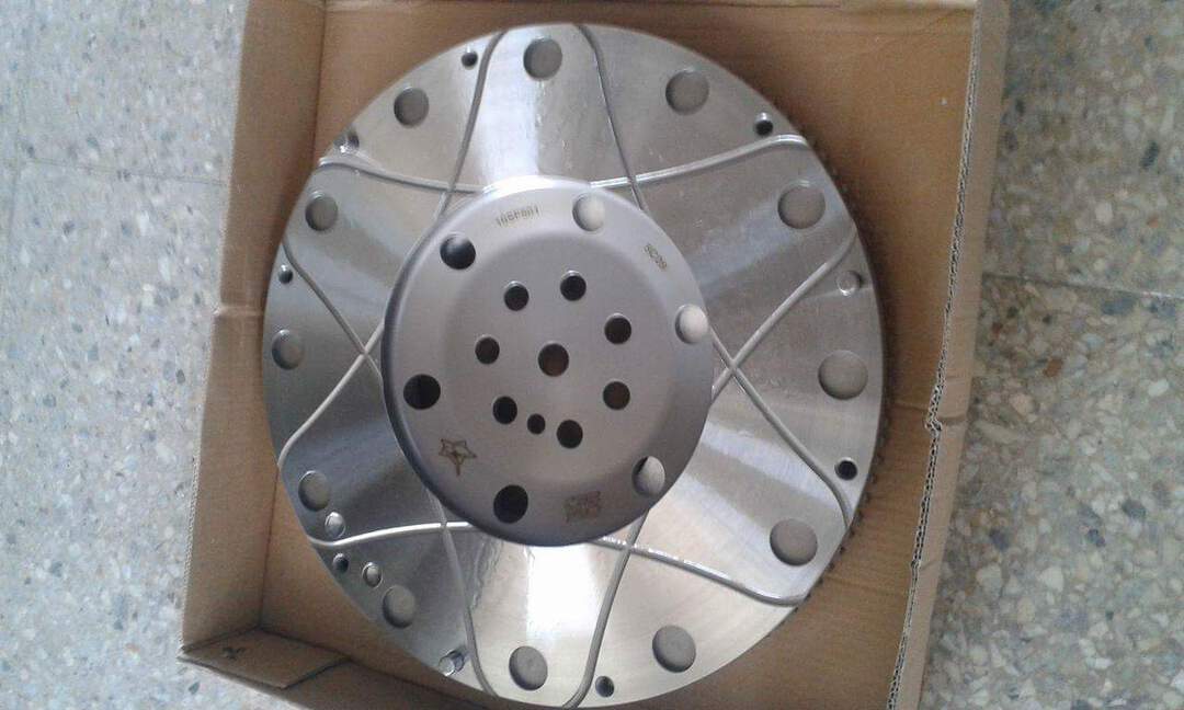

Another thing is make sure the flywheel bolts are not too long as they tend to stretch after a while and flywheel starts flapping around....I am running an after market crankshaft so maybe same thing may also happen to OEM cranks.

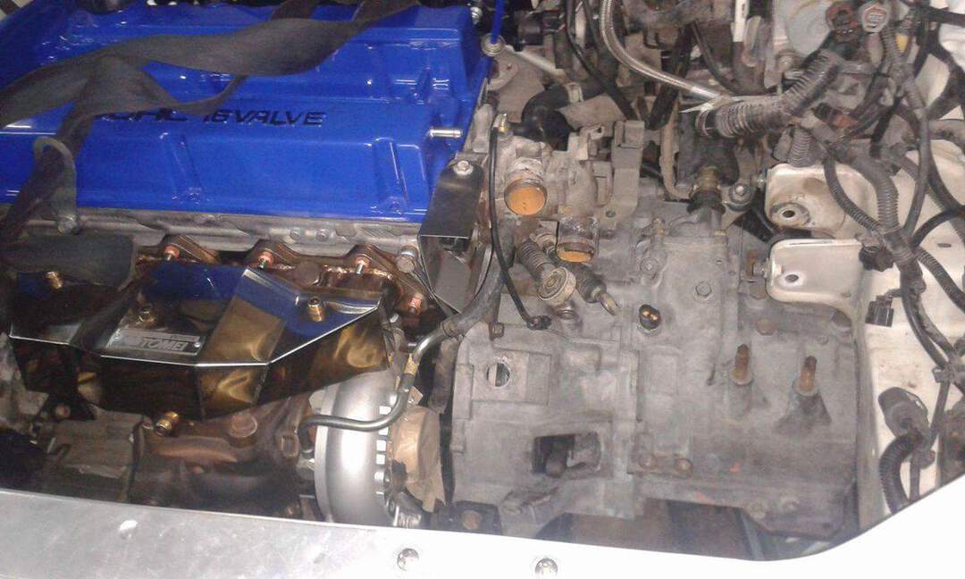

Hey salmaan many thanks on your post you are bang on i to did the centre tunnel gear shifter and hand brake and yes the clutch pedal is a bit tricky. I had to change the rear gearbox mount as the gearbox i used was an evo 9 RS the car is now running at about 400 hp but it needs tuning on the dyno for best results and have to upgrade my turbo but its the best thing to do with the car go manual car now drives like an evo currently running at 1.7 boost
