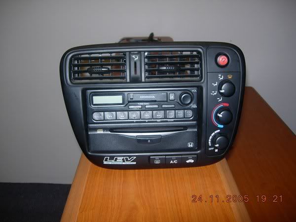

Here's mine by the way:
Gallery

my car is 99/2000 local spec model can or not if i want change Climate control only

Mine is also digital but only different climate control display which I can install 2 dins head unit.

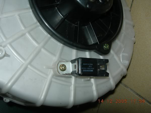

Blower
Control the fan speed so that you can control amount of air flow. The digital one has chip and plug are all differents.

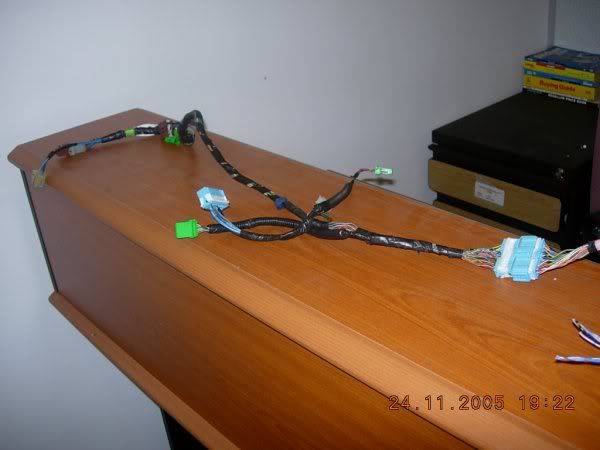

Wiring Harness
This is definitely important to make the digital climate control works since everything is wired and not using mechanical rod to pull now.

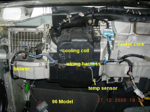

overall look for ur under dashboard - aircond system... this refer to 96 EK4 wiring

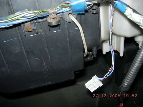

1. Wiring Harness - i believe that someone can mod it fr current wiring to digital aircond wiring outside there. but the charges i believe is more expensive than the cost for u to get another used complete set wiring harness. one thing u need to make sure when u buy the digital climate control is the wiring harness. dun simply buy the climate only.

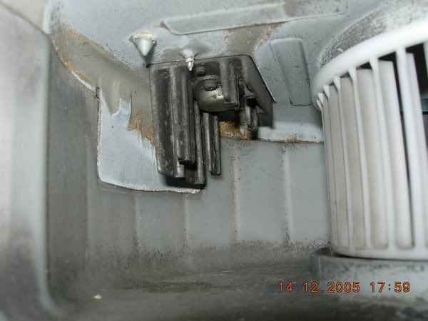

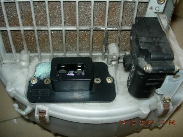

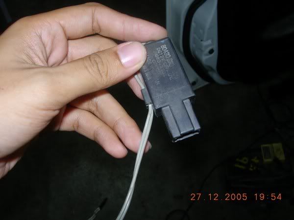

2. Digital Blower - if u refer to hondatech climate conversion the picture shown that the socket for resistor (i'm not sure what this thing call) is using 3 pin one. but actually it depen on ur wiring harness. if u got the wiring harness with 4 pin, then u have to find digital blower with 4 pin socket for the resistor. And make sure the digital blower got the relay. the location of the relay is at the bottom of the blower.

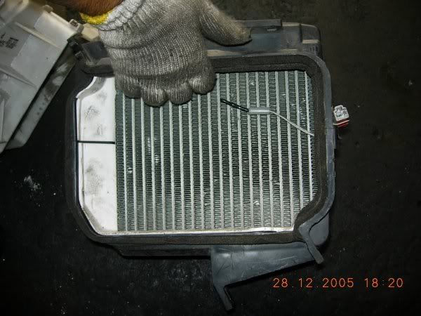

3.Cooling Coil - you can use back ur cooling coil but u need to mod wiring for the temp sensor socket since ur original one is using 3 pin socket n the digital using 2 pin socket. alternatively, u can find CRV cooling coil coz its using the same
temp sensor (2 pin).
original temp sensor socket

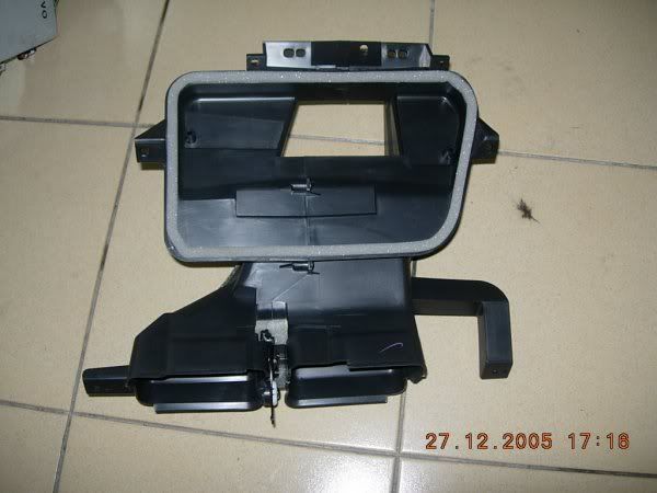

5.air vent - this air vent is located inside the dashboard and mandatory required if u converting 96 dashboard with 99 spec digital climate control. u need to dismantle the dashboard in order to install it.

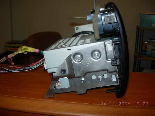

6. 99 spec climate control. better if u can get it together with the metal frame support. the frame is to support the radio unit n to be tighten to the dashboard metal frame.

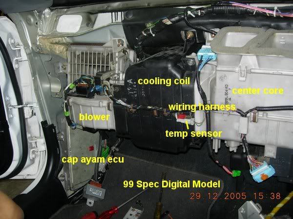

overall look for ur under dashboard - aircond system... AFTER conversion to 99 Spec Digital Climate Control.
