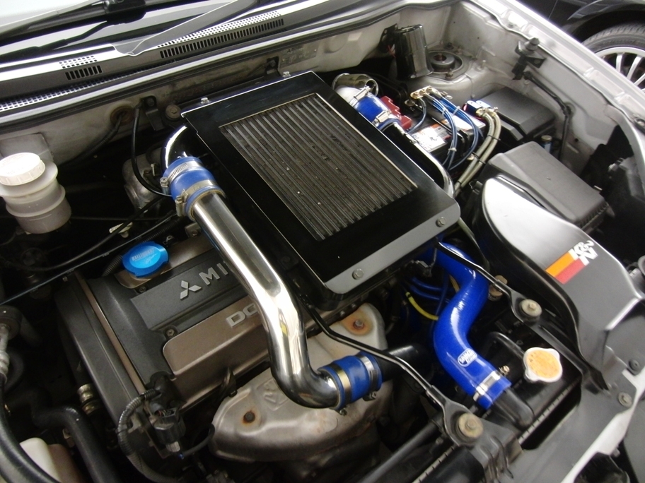

Before FMIC, I used TMIC with steel piping. Upgrade of steel piping is worth every penny if you plan to stick with the original intercooler. The stock rubber becomes soft under hot afternoons and when high boost, it tends to expand loosing pressure. I felt the difference immediately after installing in terms of response.
Back to your expectation of 210whp. You can keep everything almost stock. Just boost controller to up the boost to 1.2 bar, full exhaust, intake and DYNO TUNE, you get good power and perfect response. 210whp is not hard to achieve... good luck!
My old setup.
