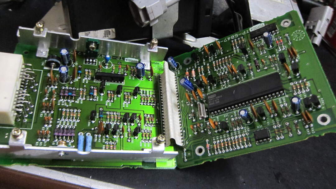

These are photos of the power steering ECUs. There are not many e-caps in there, most is 8 pcs.
Get them replaced and your power steering issue solved. These caps are cheap, cost a few cent each to a ringgit or more. Why pay 400 to 500+ ringgit for chop shop and no clue how long they will last. Buy replacing your ECu's e-caps you will be trouble free for many years.............:love:
