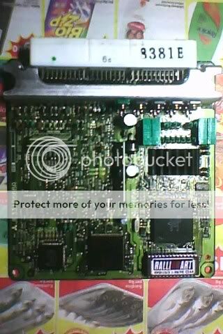

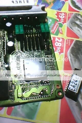

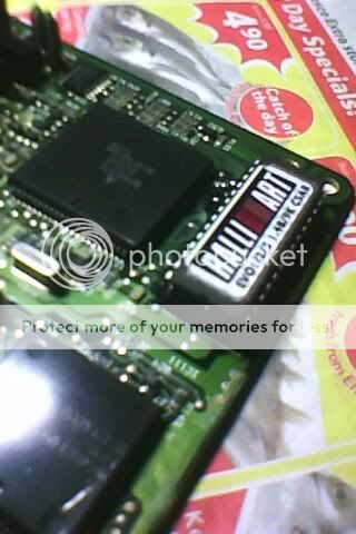

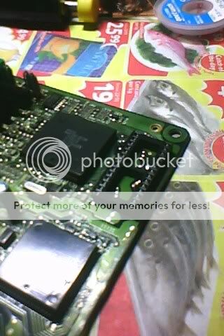

Here;s the picture of a evo ecu i did recently....
Std ecu with std chip removed
Chip socket inplaced
Chip pluged in
finally a completed ecu

Chips are copies or the original ralliart/mines program. 100% the same.
What matters is the contents....container is ST eeprom.
It is for std or stage1 mods only...
