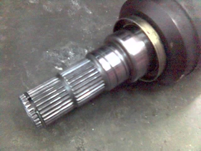

I've been noticing some repetitive clicking noises coming from my wheel well lately when coasting to a stop during traffic jams. I suspect its either the inner left driveshaft bearing giving up. I send the car to my friend's shop and he confirmed its my inner driveshaft problem. He adds that this maybe due to lowering my car previously . (really low). After taking out the driveshaft, I was shocked when my friend informed me my AT have LSD gears, hence LSD driftshaft . I was happy and at the sametime worried because you cannot get LSD driveshaft at our local spareparts shop.
Therefore, I shall be really thankful if any ceffie bros can inform me where to buy the LSD driveshaft.

tried to download earlier but couldn't
Don't look like a lsd shaft to me. which side? driver or passenger side? the factory LSD box inner shaft is very much longer on the passenger side.
Its the passenger side , send to one of the chop shop . They confirmed its lsd but they dont have stock , have to look for it. I noticed there are like 2 sets of gears on the end of the shaft.

you using original or chop shop g.box? from the look of it, it look normal shaft. i am using a lsd box, i mine sure look much longer than the one show on your picture.
I swapped the whole JDM half-cut 4 years ago. (even the meter reads max speed 180kph). I was using it for 4 years now, didn't realised the 'lsd driveshaft ' until it was dismantled by the workshop recently .
SB3.
then get the 2.5L box, some come with vLSD, also you can use back the 260km/h meter. i am using one.
Worse, you get a similar size shaft, swap the bearing inside.
