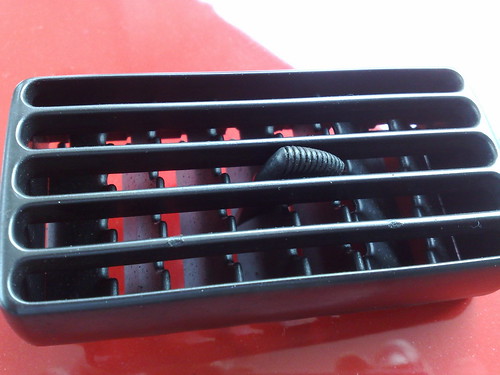

then remove the grill from the duct, take out from the side that have open end as show below.
010120101822
remove and clear the broken stem that holding the vanes. it not difficult as it quite 'breakable'.
010120101812

tools you need,
a long end playar and wire.
http://www.flickr.com/photos/min-min/4233312553/010120101813
measure the gap of each vane, you may use the playar thickness as a guide by putting the playar on top of the grill and judge the gap between the hold that holding the vane. this is to ease to twist the wire later.
010120101814
start bend a small circle at the end of the wire using the tips of the playar. after that, put the wire in the middle of the playar (just now u have judge the gap with the playar) bend the wire to 90 degree to mark where to bend the wire to second cirlce.
http://www.flickr.com/photos/min-min/4234086544/010120101815
010120101816
after the success making the second holes, you may feel exciting..:rofl::rofl::rofl: hehehe..coz u are on business now... but not too happy yet.. measure the distance of the 2 holes 1st see whether it aline with the vanes gap or not... you can light another cigratte when you are doing that... haha..:smokin::smokin::smokin::smokin:
http://farm5.static.flickr.com/4010/4233313553_ab589f535b_m.jpg
haha... but it feel quite hot when you are doing it.. haha...
:rofl::rofl::rofl:
tiu, why the photo now show up already?
---------- Post added at 01:38 AM ---------- 6 hour anti-bump limit - Previous post was at 01:26 AM ----------
so, then you repeat the same things for the other holes on the wire. after finished, check the holes u make aline with the vanes or not.
010120101818
then some patient you need here.
position the vanes, start hock up the wire to the vanes from one end. then hock the hole wire in. you may need a few attempt to do this as the other vanes might run out of position.
http://farm3.static.flickr.com/2725/4233314065_fea088739e_m.jpg
after that gently press the wire circle to make it 'bite' on the vane abit with the playar so that it won;t fall off. you may need to try to move the vane around after you press each of the cirlce. this to make sure it won;t press to hard and jammed up the vanes. for me i just press the middle and both end of the wire. other vane l leave it have some free play.
010120101820
finished product.:biggrin: want to buy??? heavy duty SW20 aircon vanes. hahaha.
.:rofl::rofl::rofl:
010120101821
