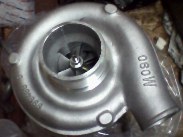

Garrett 60-1 Stage III..:love:..i don't really know about turbo..but what i'm looking for is more about 400-500hp...can achieve ar??hahahaha..please advice..and currently i'm running my engine on stock 16G..therefore..buying the garrett 60-1 might take sometime..
u might be able to run 60-1 even with the stock engine if u buy the 60-1 with bep housing..spool kick in around 3.8k rpm in stock vr4..!
u can go with stage 3 but i do prefer stage 4 p trim...
or..go for s256 dsm non ett..4g63 stock ? no problemmo...Pnp to stock manifold
