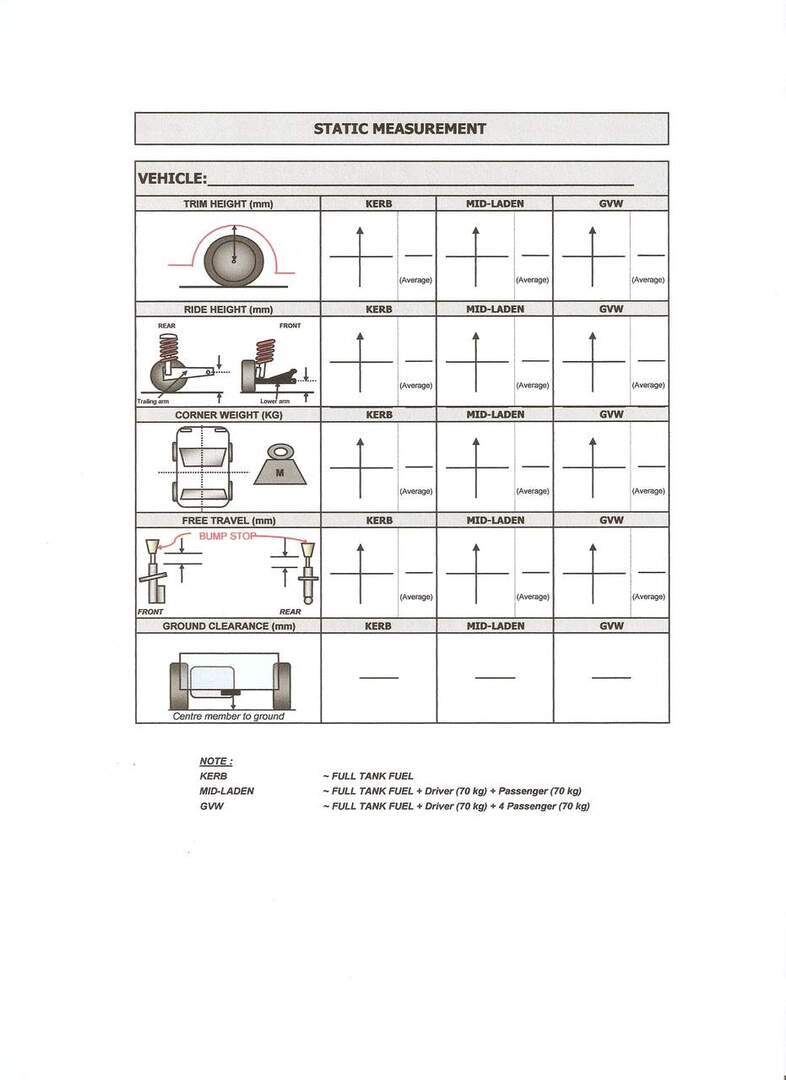

For a start I would like to get a data on Trim Height of our standard DC5 with stock suspension and tyres 215/45/17. Trim Height is the distance between the wheel centre and the wheel arch. It's quite easy to measure just using a measuring tape, however, the condition of the car must be:
1. Car must be level on a flat surface like a 4-post lifter/hoist (if your house garage is flat also can)
2. Kerb weight (Full Tank Fuel)
Since I didn't take the measurement last time on my car, I would appreciate those who still with the stock condition to provide it. If you have lightened your car a bit thats okay since it's difficult to get bone stock car coz most of us sure mod it rite after getting the car.

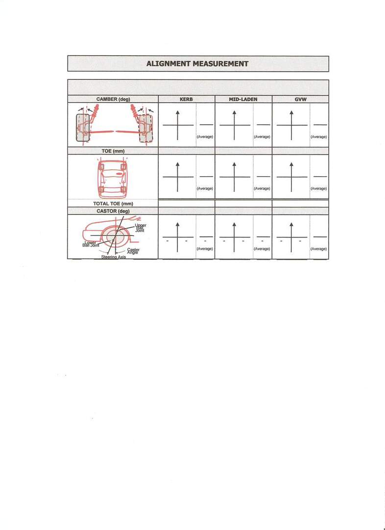

I also attached 2 forms for everyone who's interested to use the forms for your own record. These are some of the forms I used last time when doing R&H development. The cross with arrow in the form is for us to write the FrontLeft/FrontRight/RearLeft/RearRight measurements. Pls use millimeters(mm).
(note: ground clearance of DC5 not from centre member but from our exhaust since thats the lowest point, the one in the form is for proton cars)
Those who is not in stock condition also can share your data here...many people can benefit from it too. Pls mention your suspension mod or even a short review would be nice.
If the ground is not level also can but pls mention where you park like your house, workshop or even on the beach :biggrin:

Kerb weight is the condition of the car with full fuel...I'm not asking you to weight the car. No driver should sit in the car when you take the trim height. but make sure you fill up full fuel...this is kerb weight condition.
We all know the kerb weight is 1180kg...this weight is taken with full fuel inside the car.
This is the condition of the car when you want to measure the trim height.
So, don't put your golf bag inside the car when you measure coz it's not kerb weight anymore.
