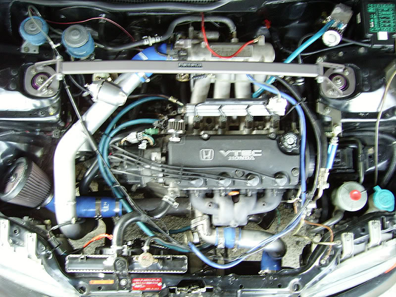

Ok.. to all the brothers or sisters in ZTH, some questions from junior here
Have anyone BOT a D16A engine before?
I plan to go for it, but only wanted to get on low boost lets say around 0.6-0.8 bar maybe.
I just bought a manual gearbox with LSD for D16A and i get an Exedy racing clutch already.
so i was planning who has the experience for the SOHC VTEC Turbo. please let me know.
1) What piston and conrod to upgrade to?
2) what injector to use? 250 cc? 450cc?
3) What turbo maybe be applicable for better response and low boost?
4) how to save cost?
5) where to get the turbo manifold?
6) on low boost do i have to upgrade my bearings?
7) piping size?
8) etc, please share your experience.
P.S. Just want a normal turbo ride, not for DRAG or Show off, i just love turbo and driving. :driver:

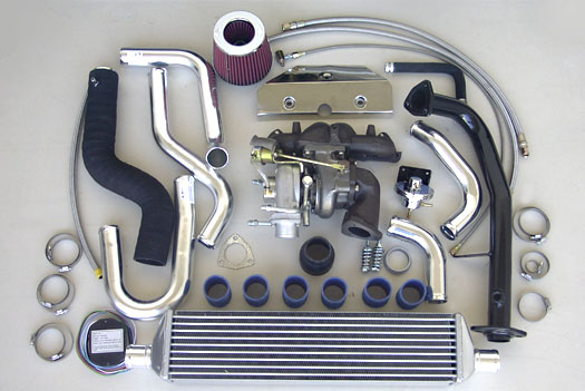

Saw 1 Honda turbo kit cost RM6.8k,for me is worth..but excluded "air filter","injector","fuel pump"..tuning included but not stated which ECU used 4 it..sweat...not complete yet,still gonna buy here buy there...(-.-")
http://www.zerotohundred.com/newforums/engine-and-performance/81740-honda-turbo-kits-11.html

- infinite d16 manifold rm500
- turbine sr20 or rb25 (that fit the banana tapak) rm500
- tial imit. wastegate rm300 (maybe i should go for original?)
- bov rm150
- FMIC kit rm1k
- boost ctlr ?
- injector/fuelrail combo (not sure price, still scouting)
- fuel pump n fuel regulator ?
yup, installer n tuner also important which i dont know who is willing to tune a rojak turbo.
my aim is just low boost 0.3 while using my existing 2" piping n stock internals for now.
Also, is D16 non-vtec conrod is too weak to support under 0.5 bar boost application?
thanks in advance
-The RB25 turbo is T3 flange. So, it's a plug n play.
-The turbo comes with internal wastegate. So, tial is optional.
-BOV, my friend and I have personally tried synapse imitation. As good as the the originals. And still holding strong at 35 psi.
-FMIC, JASMA or China ACR will do. Forget about the big big intercooler if u are looking for response -and torque. The GSR front side mount is good. Or, the Mitsubishi V6 Twin turbo is good and they both cost -Boost controller is built in on the internal wastegate actuator. There's a screw to adjust. The aftermarket boost controller is to increase boost and not decrease.
-The non Vtec is as good as the Vtec rods.
-Injectors and fuel rail. Ur stock fuel rails are more than good for ur proposed application. regarding the injectors, u can opt for the Mitsubishi 4G93T injectors(390cc) which require a resistor pack u can purchase from Jalan Pasar. Just get the resistor for alternative current(long square white color) 10W 10ohm.
Hope this helps....
